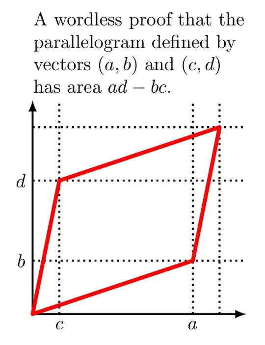

Spend a little time with this figure due to Solomon W. Golomb and enlightenment is not far off:
(Appeared in Mathematics Magazine, March 1985.)

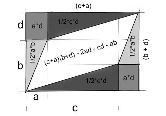

I know I'm extremely late with my answer, but there's a pretty straightforward geometrical approach to explaining it. I'm surprised no one has mentioned it. It does have a shortcoming though - it does not explain why area flips the sign, because there's no such thing as negative area in geometry, just like you can't have a negative amount of apples(unless you are economics major).
It's basically:
  Parallelogram = Rectangle - Extra Stuff.
If you simplify $(c+a)(b+d)-2ad-cd-ab$ you will get $ad-bc$.
Also interesting to note that if you swap vectors places then you get a negative(opposite of what $ad-bc$ would produce) area, which is basically:
  -Parallelogram = Rectangle - (2*Rectangle - Extra Stuff)
Or more concretely:
$(c+a)(b+d) - [2*(c+a)(b+d) - (2ad+cd+ab)]$
Also it's $bc-ad$, when simplified.
The sad thing is that there's no good geometrical reason why the sign flips, you will have to turn to linear algebra to understand that.
Like others had noted, determinant is the scale factor of linear transformation, so a negative scale factor indicates a reflection.

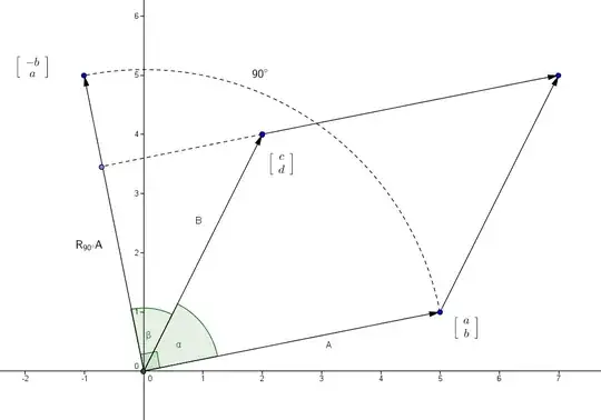

For the matrix $\left[\begin{array}{cc} a & c \\ b & d \\ \end{array}\right]$ let $$A = \left[\begin{array}{c} a \\ b \\ \end{array}\right] \;\text{and}\; B = \left[\begin{array}{c} c \\ d \\ \end{array}\right]$$
as shown in the following figure.
Determinant Figure
Then the height of the parallelogram is
$$\text{height} = |B|\sin\alpha = |B|\cos\beta.$$
If we rotate $A$ by 90 degrees in the CCW direction as follows:
$$R_{90º}A = \left[\begin{array}{cc} 0 &-1 \\ 1 &0 \\ \end{array}\right] \left[\begin{array}{c} a \\ b \\ \end{array}\right] = \left[\begin{array}{c} -b \\ a \\ \end{array}\right],$$
maintaining the magnitude of the base as
$$\text{base} = |A| = |R_{90º}A|,$$
then it is clear that the area of the parallelogram is therefore
$$ \text{base}\times\text{height}=(|A|)(|B|\sin\alpha) = |R_{90º}A|\;|B|\cos\beta = (R_{90º}A)\cdot B = \left[\begin{array}{c} -b \\ a \\ \end{array}\right] \cdot \left[\begin{array}{c} c \\ d \\ \end{array}\right] = ad-bc. $$ Q.E.D.
Chappers
  • 67,606
Tpofofn
  • 4,771
    +1. While it's clear that $|A|\sin\alpha=|R_{90^\circ}A|\cos\beta$, it may be visibly clearER in your diagram that $|\text{altitude of parallelogram}|=|B|\sin\alpha=|B|\cos\beta$ ... which ---since $|A|=|R_{90^\circ}A|$--- works just as well in your argument. (Drawing the altitude from the tip of $B$ onto $A$ would help drive this home.) – Blue Mar 13 '12 at 03:29

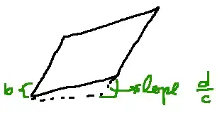

I keep forgetting the tricks to prove this so I found the only way to remember it is to stick to basic principles. We can deform the parallelogram to get a square like so. enter image description here
Now we only need to find the side lengths of this rectangle. The height is easy, it's just d. To get the base length, we find:
and so with a little algebra we find that the base length is $a-b\times\frac{c}{d}$.
Hence the area is just $$ d(a-\frac{bc}{d}) = ad - bc$$
samlaf
  • 870
  • Very nice answer! Thank you. – Mahathi Vempati Jun 06 '17 at 04:46
  • I did not get the part where you said, 'with a little algebra'. Could you please explain your steps how you come to the fact that the base length of your rectangle equals: $a-b*c/d$? – Mark Feb 17 '21 at 01:45
  • What is the length of the horizontal green line? – samlaf Feb 17 '21 at 01:47
  • The base length is $a - x$, where $x$ is the basis of the green triangle. That green triangle has height $b$ and a opposite angle $\alpha$. Then $$x = b/\tan(\alpha)$$ But note that $\alpha$ is the angle of the vector $(c,d)$ with the x-asix, then $\tan(\alpha) = d/c$. Hence $$x = b*c/d$$ The result follows – Astrid A. Olave H. May 31 '23 at 15:12

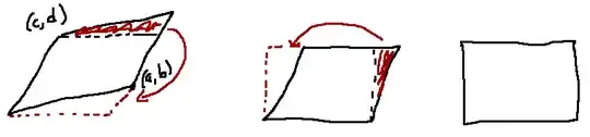

Here is an animated gif I made to derive the area of a parallelogram.
wordless proof about area of parallelogram
If you compute the cross product of (a,b,0) and (c,d,0), then you get (in the third coordinate) ad-bc. This is, up to the sign, the area of the parallelogram.

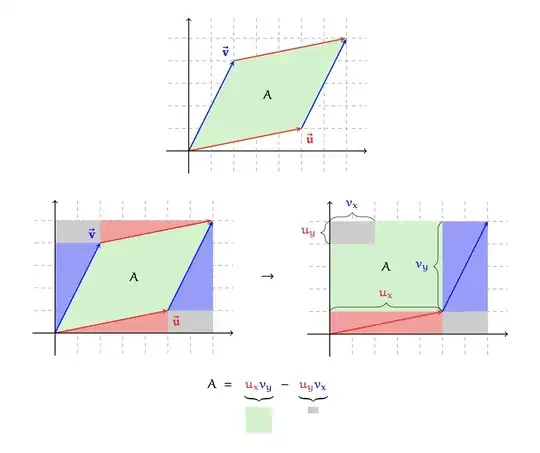

I made the following slide to explain where this formula comes from:

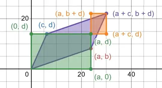

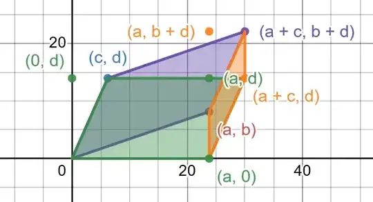

Another geometric proof using an animation in desmos:
The green rectangle and parallelogram have the same base and height:
$\operatorname{green}=\operatorname{area}\left((0,0)(a,0)(a,d)(0,d)\right)=ad= \operatorname{area}\left((0,0)(a,0)(a,{c}+d)(c,d)\right).$
The orange rectangle and parallelogram have the same base and height:
$\operatorname{orange}=\operatorname{area}\left((a,d)(a+c,d)(a+c,b+d)(a,b+d)\right)=bc= \operatorname{area}\left((a,0)(a+c,d)(a+c,b+d)(a,b)\right).$
The violet, green and orange parallelograms have the same bases, the height of green parallelogram is the sum of heights of violet and orange parallelograms.
$\operatorname{violet} + \operatorname{orange} = \operatorname{green}$
$\operatorname{violet}=\operatorname{area}\left((0,0)(a,b)(a+c,b+d)(c,d)\right) = \operatorname{green} - \operatorname{orange} = ad-bc$

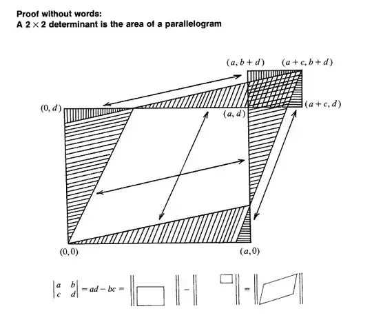

Here is a proof without words: enter image description here
Jules
