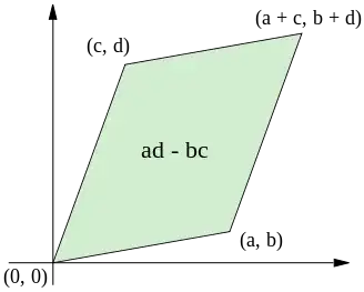

It helps many students to "visualize" the determinant of a $2 \times 2$ matrix geometrically, to better understand the determinant, as representing the area of a parallelogram. (This can be found in many standard books.):
Area
So you can clearly see that if $ad-bc=0$ then the parallelogram suddenly becomes a straight line (having no area).
For a $3\times 3$ matrix, we have that the value of the determinant is equal to the volume of a parallelepiped whose coordinates correspond to the matrix's entries. When such a determinant is zero the parallelepiped suffers a decrement by one dimension by one (hence, is without volume).

  • Some musing: I always found the geometric application as the area of a parallelogram artificial. It is too often stated as fact in textbooks without explanation. The spin on this that I like is to emphasize that $A$ is a transformation (which could be applied to the vectors $\vec{e}_1$ and $\vec{e}_2$). And that that transformation uniformly scales volume (or area). And that the images of $\vec{e}_1$ and $\vec{e}_2$ are precisely the column vectors of $A$. And therefore the area of that parallelogram is whatever $A$'s scaling factor is, applied to the area of the $1\times1$ square. – 2'5 9'2 Nov 13 '12 at 00:56

When I teach linear algebra courses, the first time I discuss the determinant of a matrix $A$, I describe it as the number by which $A$ scales area. Starting with a $2\times 2$ example, I sketch a unit square with a corner at the origin, apply $A$, and see that my square is now some kind of parallelogram, and its $1$ unit of area has been rescaled by some value. I do it with other familiar shapes too that may or may not touch the origin - say a triangle. This is to make it clear that there was nothing special about the unit square; $A$ is scaling every little bit of area everywhere by the same number.
With good drawing skills or software, you can upgrade this to volume in 3-space too.
And after all this I come back to other perspectives on what a determinant is. Clarity on this first perspective though makes certain things more clear, like one reason why $\det(AB)=\det(A)\det(B)$.
