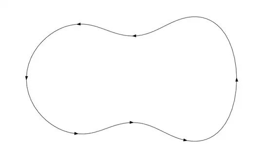

Here's an intuitive way to discover Green's theorem. This is similar to the way that physicists derive Green's theorem. (My goal here is to provide intuition, not a rigorous proof.)
Let $D$ be a region in $\mathbb R^2$ whose boundary is a smooth closed curve $C$. I'll assume that $C$ is oriented counterclockwise: enter image description here Now imagine chopping up $D$ into tiny pieces such that each tiny piece is a parallelogram (or at least, each tiny piece is approximately a parallelogram). The following picture is best viewed full screen: enter image description here
Let $C_i$ be the boundary of the $i$th tiny parallelogram. I'll assume each $C_i$ is oriented counterclockwise. Notice that if $f$ is a smooth vector field on $\mathbb R^2$ then $$ \sum_i \int_{C_i} f \cdot dr = \tag{1} \int_C f \cdot dr. $$ This is because the sum on the left "telescopes". Everything in the middle cancels out and we are left only with boundary terms. This beautiful step in the derivation is reminiscent of the telescoping sum that appears when deriving the fundamental theorem of calculus in single variable calculus.

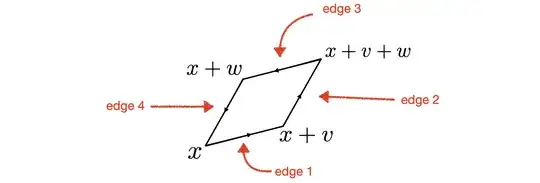

To complete our derivation of Green's theorem, we must compute the integral of $f$ around the boundary of a tiny parallelogram. Below is a picture of one single tiny parallelogram which is based at a point $x = \begin{bmatrix} x_1 \\ x_2 \end{bmatrix} \in \mathbb R^2$ and which is spanned by vectors $v = \begin{bmatrix} v_1 \\ v_2 \end{bmatrix}$ and $w = \begin{bmatrix} w_1 \\ w_2 \end{bmatrix} \in \mathbb R^2$. The boundary of the parallelogram is oriented counterclockwise:
Since this is a very tiny parallelogram, I'll make the approximation that the integral of $f$ along edge 1 is approximately $f(x) \cdot v$, the integral of $f$ along edge 2 is approximately $f(x + v) \cdot w$, the integral of $f$ along edge 3 is approximately $f(x + w) \cdot (-v)$, and the integral of $f$ along edge 4 is approximately $f(x) \cdot (-w)$. Summing these four terms, and pairing edge 1 with edge 3 and edge 2 with edge 4, we find that the integral of $f$ along the boundary of this parallelogram is approximately \begin{align*} &\quad \langle f(x+v) - f(x), w \rangle - \langle f(x + w) - f(x), v \rangle \\ \approx & \quad \langle f'(x) v, w \rangle - \langle f'(x) w, v \rangle \\ \tag{2} &= \left(\frac{\partial f_2(x)}{\partial x_1} - \frac{\partial f_1(x)}{\partial x_2} \right) \underbrace{(v_1 w_2 - v_2 w_1)}_{\text{Area of parallelogram}}. \end{align*} Here $f_1$ and $f_2$ are the component functions of $f$, and $ f'(x) = \begin{bmatrix} \frac{\partial f_1(x)}{\partial x_1} & \frac{\partial f_1(x)}{\partial x_2} \\ \frac{\partial f_2(x)}{\partial x_1} & \frac{\partial f_2(x)}{\partial x_2} \end{bmatrix} $ is the Jacobian matrix of $f$ at $x$.
The final step is to apply formula (2) to the sum on the left in equation (1). Let $\Delta A_i$ be the area of the $i$th tiny parallelogram, and let $x^i \in \mathbb R^2$ be the point where the $i$th tiny parallelogram is based. (The $i$ here is a superscript, not an exponent.) Combining formulas (1) and (2) reveals that \begin{align} \int_C f \cdot dr &\approx \sum_i \left(\frac{\partial f_2(x^i)}{\partial x_1} - \frac{\partial f_1(x^i)}{\partial x_2} \right) \Delta A_i \\ &\approx \int_D \frac{\partial f_2(x)}{\partial x_1} - \frac{\partial f_1(x)}{\partial x_2} \, dA. \end{align} We have discovered the Green's theorem formula. It seems plausible that we can make the approximation as accurate as we like by chopping up $D$ into sufficiently small pieces. Thus, we conclude that $$ \int_C f \cdot dr = \int_D \frac{\partial f_2(x)}{\partial x_1} - \frac{\partial f_1(x)}{\partial x_2} \, dA $$

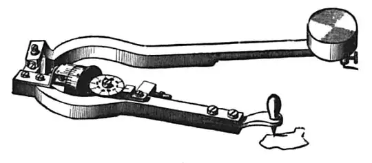

If you need a motivation you can introduce them to the Planimeter.https://upload.wikimedia.org/wikipedia/commons/0/01/Planimeter.png
It's a wonderful little device that is used to measure the area of a figure, following the wikipedia page,
The Amsler (polar) type consists of a two-bar linkage. At the end of one link is a pointer, used to trace around the boundary of the shape to be measured. The other end of the linkage pivots freely on a weight that keeps it from moving. Near the junction of the two links is a measuring wheel of calibrated diameter, with a scale to show fine rotation, and worm gearing for an auxiliary turns counter scale. As the area outline is traced, this wheel rolls on the surface of the drawing. The operator sets the wheel and turns counter to zero if they're not, already, then traces the pointer around the perimeter of the shape. When the tracing is complete, the scales at the measuring wheel show the shape's area.
"How does it work?!", you student may ask. That's when you introduce Green's Theorem!
