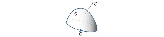

Let $S$ be a smooth oriented surface in $\mathbb R^3$ with boundary $C$, and let $f: \mathbb R^3 \to \mathbb R^3$ be a continuously differentiable vector field on $\mathbb R^3$.
Stokes's theorem states that $$ \int_C f \cdot dr = \int_S (\nabla \times f) \cdot dA. $$ In other words, the line integral of $f$ over the curve $C$ is equal to the integral of the curl of $f$ over the surface $S$. Here the orientation of the boundary $C$ is induced by the orientation of $S$.
Question: How might somebody have derived or discovered this formula? Where does this formula come from?
The goal is to provide an intuitive explanation of Stokes's theorem, rather than a rigorous proof.
(I'll post an answer below.)

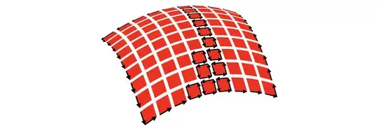

Here's an intuitive way to discover Stokes's theorem.
Imagine chopping up the surface $S$ into tiny pieces such that each tiny piece is a parallelogram (or at least, each tiny piece is approximately a parallelogram).
Let $C_i$ be the boundary of the $i$th tiny parallelogram. I'll assume each $C_i$ has the orientation induced by the orientation of $S$. Notice that $$ \tag{1} \sum_i \int_{C_i} f \cdot dr = \int_C f \cdot dr. $$ This is because the sum on the left "telescopes". Everything in the middle cancels out and we are left only with boundary terms. This beautiful step in the derivation is reminiscent of the telescoping sum that appears when deriving the fundamental theorem of calculus in single variable calculus.
To complete our derivation of Stokes's theorem, we must compute the integral of $f$ around the boundary of a tiny parallelogram. Below is a picture of one single tiny parallelogram which is based at a point $x = \begin{bmatrix} x_1 \\ x_2 \\ x_3 \end{bmatrix} \in \mathbb R^3$ and which is spanned by vectors $v = \begin{bmatrix} v_1 \\ v_2 \\ v_3 \end{bmatrix}$ and $w = \begin{bmatrix} w_1 \\ w_2 \\ w_3 \end{bmatrix} \in \mathbb R^3$. The orientation of the boundary of the parallelogram is indicated by the little direction arrows.
Since this is a very tiny parallelogram, I'll make the approximation that the integral of $f$ along edge 1 is approximately $f(x) \cdot v$, the integral of $f$ along edge 2 is approximately $f(x + v) \cdot w$, the integral of $f$ along edge 3 is approximately $f(x + w) \cdot (-v)$, and the integral of $f$ along edge 4 is approximately $f(x) \cdot (-w)$. Summing these four terms, and pairing edge 1 with edge 3 and edge 2 with edge 4, we find that the integral of $f$ along the boundary of this parallelogram is approximately \begin{align*} &\quad \langle f(x+v) - f(x), w \rangle - \langle f(x + w) - f(x), v \rangle \\ &\approx \langle f'(x) v, w \rangle - \langle f'(x) w, v \rangle \\ &= \langle v, (f'(x)^T - f'(x)) w \rangle \\ &= \left \langle v, \begin{bmatrix} 0 & \frac{\partial f_2(x)}{\partial x_1} - \frac{\partial f_1(x)}{\partial x_2} & \frac{\partial f_3(x)}{\partial x_1} - \frac{\partial f_1(x)}{\partial x_3} \\ \frac{\partial f_1(x)}{\partial x_2} - \frac{\partial f_2(x)}{\partial x_1} & 0 & \frac{\partial f_3(x)}{\partial x_2} - \frac{\partial f_2(x)}{\partial x_3} \\ \frac{\partial f_1(x)}{\partial x_3} - \frac{\partial f_3(x)}{\partial x_1} & \frac{\partial f_2(x)}{\partial x_3} - \frac{\partial f_3(x)}{\partial x_2} & 0 \end{bmatrix} w \right\rangle \\ &= \langle v, w \times (\nabla \times f) \rangle \\ &=\tag{2} \langle \nabla \times f, \underbrace{v \times w}_{\substack{\text{Area vector}\\ \text{for this tiny} \\ \text{parallelogram}}} \rangle. \end{align*}
Here $f_1, f_2$, and $f_3$ are the component functions of $f$ and $ f'(x) = \begin{bmatrix} \frac{\partial f_1(x)}{\partial x_1} & \frac{\partial f_1(x)}{\partial x_2} & \frac{\partial f_1(x)}{\partial x_3} \\ \frac{\partial f_2(x)}{\partial x_1} & \frac{\partial f_2(x)}{\partial x_2} & \frac{\partial f_2(x)}{\partial x_3} \\ \frac{\partial f_3(x)}{\partial x_1} & \frac{\partial f_3(x)}{\partial x_2} & \frac{\partial f_3(x)}{\partial x_3} \\ \end{bmatrix} $ is the Jacobian matrix of $f$ at $x$. The vector $\nabla \times f$, which is called the "curl" of $f$ at $x$, is defined by $$ \nabla \times f = \begin{bmatrix} \frac{\partial f_3(x)}{\partial x_2} - \frac{\partial f_2(x)}{\partial x_3} \\ \frac{\partial f_1(x)}{\partial x_3} - \frac{\partial f_3(x)}{\partial x_1} \\ \frac{\partial f_2(x)}{\partial x_1} - \frac{\partial f_1(x)}{\partial x_2} \end{bmatrix}. $$ This is the moment in math when we discover the curl for the first time. Technically, I should write the curl of $f$ at $x$ as $(\nabla \times f)(x)$.
The final step in our derivation of Stokes's theorem is to apply formula (2) to the sum on the left in equation (1). Let $\Delta A_i$ be the "area vector" for the $i$th tiny parallelogram. In other words, the vector $\Delta A_i$ points outwards, and the magnitude of $\Delta A_i$ is equal to the area of the $i$th tiny parallelogram. Let $x^i \in \mathbb R^3$ be the point where the $i$th tiny parallelogram is based. (The $i$ here is a superscript, not an exponent.) Combining formulas (1) and (2) reveals that \begin{align} \int_C f \cdot dr &\approx \sum_i (\nabla \times f)(x_i) \cdot \Delta A_i \\ &\approx \int_S (\nabla \times f) \cdot dA. \end{align} We have discovered the Stokes's theorem formula. It seems plausible that we can make the approximation as accurate as we like by chopping up $S$ into sufficiently small pieces. Thus, we conclude that $$ \int_C f \cdot dr = \int_S (\nabla \times f) \cdot dA $$

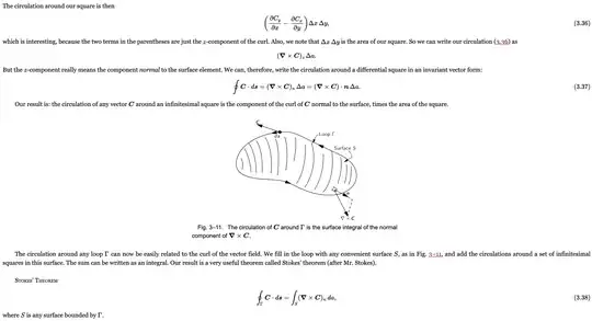

    "If you know of a source which does this" Joos's Theoretical Physics derives Stoke's theorem this way: img. The first equation there is essentially his definition of the curl though, he won't calculate a coordinate expression for it til the next page. – scurest Dec 04 '21 at 18:47
  • @ToddWilcox Thank you, that's great. I wrote some notes about the intuition behind calculus on manifolds. The notes discuss orientation and also give a derivation of the generalized Stokes's theorem which is similar to the derivation of the classical Stokes's theorem that I gave here. – littleO Dec 04 '21 at 21:00
  • @scurest Thanks. What I meant to say is that I haven't seen a source which gives a similar derivation for the curl formula specifically. I updated the comment accordingly. I'll have to take a look at Joos to see how they arrive at the curl formula. – littleO Dec 04 '21 at 21:03
