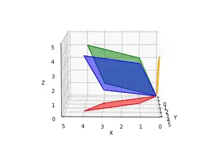

Here is a visualization of the projections with $\mathbf a=(3,2,1),\mathbf b=(1,2,3)$:
visualization
  • The $\mathrm{\color{blue}{blue}}$ parallelogram is spanned by $(3,2,1),(1,2,3)$. (original parallelogram in 3D space)
  • The $\mathrm{\color{orange}{orange}}$ parallelogram is spanned by $(0,2,1),(0,2,3)$. (projected onto y-z plane)
  • The $\mathrm{\color{green}{green}}$ parallelogram is spanned by $(3,0,1),(1,0,3)$. (projected onto x-z plane)
  • The $\mathrm{\color{red}{red}}$ parallelogram is spanned by $(3,2,0),(1,2,0)$. (projected onto x-y plane)
The Pythagorean Theorem says the areas of the parallelogram have the relationship:
$$||\mathrm{\color{blue}{blue}}||^2=||\mathrm{\color{orange}{orange}}||^2+||\mathrm{\color{green}{green}}||^2+||\mathrm{\color{red}{red}}||^2$$
$$\sqrt{96}^2=4^2+8^2+4^2$$
