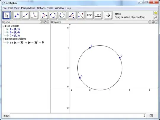

Follow these steps:
  1. Consider the general equation for a circle as $(x-x_c)^2+(y-y_c)^2 - r^2 = 0$
  2. Plug in the three points to create three quadratic equations $$ (1-x_c)^2+(1-y_c)^2 - r^2 = 0 $$ $$ (2-x_c)^2+(4-y_c)^2 - r^2 = 0 $$ $$ (5-x_c)^2+(3-y_c)^2 - r^2 = 0 $$
  3. Subtract the first from the second, and the first from the third to create two linear equations $$ -2 x_c -6 (y_c-3)=0 $$ $$ (y_c+7)-6 x_c = 0 $$
  4. Solve for the center as $$ (x_c,y_c) = (3,2) $$
  5. Plug the values for the center in any of the three quadratic equations above (I choose the first) and solve for $r$ $$ (1-3)^2+(1-2)^2-r^2 = 0 $$ $$ 5-r^2 = 0 $$ $$ r = \sqrt 5 $$
  6. Verify result with GeoGebra (optional)
ScreenShot

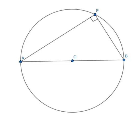

Let $P(x,y)$ be any point on the circle. Then, $\angle APB$ is an angle in a semicircle and is hence a right angle. By writing $m_{AP}\cdot m_{BP}=-1$, we have $$\left(\frac{y-y_1}{x-x_1}\right)\left(\frac{y-y_2}{x-x_2}\right)=-1$$$$\implies (y-y_1)(y-y_2)+(x-x_1)(x-x_2)=0$$ is the equation of $\Omega$. Now, the straight line, $L$, through $A$ and $B$ is $$\frac{y-y_1}{x-x_1}= \frac{y_2-y_1}{x_2-x_1}$$$$\implies (y-y_1)(x_2-x_1)-(x-x_1)(y_2-y_1)=0$$
Now we will write the equation of a family of circles passing through $A$ and $B$. This can be written as $$\Omega +\lambda L=0$$ and this can be verified to being a circle for all $\lambda$. Now you can understand why we found the equation of $\Omega$: to find a similar (to the required curve) but special curve passing through the points of interest.
Now, put $(x_3,y_3)$ in the equation and solve for $\lambda$. This will give the required equation of the circle.
