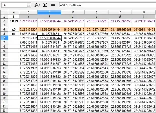

You know that there is a solution $x_k$ in a neighbourhood of $2 \pi k$, for each integer $k$.
And the equation can be also written as
$x_k = \arctan(x_k) + 2 k \pi$
where the arc tangent returns the principal value.
Then you can iterate:
$x_k[0] = 2 k \pi$
$x_k[n] = \arctan(x_k[n-1]) + 2 k \pi$
It converges very quickly - empirically - proof is left as an exercise :)
