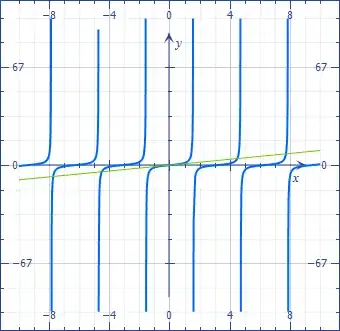

I mean, is there a way to solve analytically something like this:
$$ \tan(x) - x = 0 $$

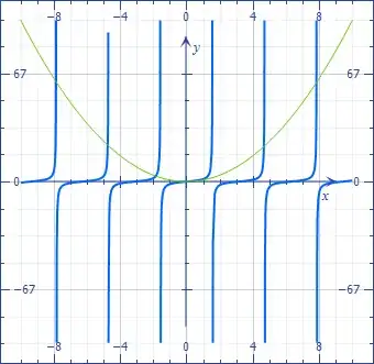

or like this equation
$$ \tan(x) - x^2 = 0 $$
I know this will produce infinite number of roots but could they be represented by some simple formula?

By looking at the plot of the $\tan$ function, you observe that the straight line $y=x$ tangents it (no pun) at the origin, then crosses the curve near the vertical asymptotes at $x=\pm(k+\frac12)\pi$ for integer $k>0$.
Because of the singularity, these values cannot be taken as starting values for Newton iterations. We can work around this by setting $x=t\pm(k+\frac12)\pi$, for small $t$. Then $\tan x\approx-\frac1t$, and $$-\frac1t=t\pm(k+\frac12)\pi\approx\pm(k+\frac12)\pi,$$ $$x\approx\pm(k+\frac12)\pi\mp\frac1{(k+\frac12)\pi}.$$
In the case of $\tan x=x^2$, the asymptotes are crossed even closer, but in an asymmetric way. The $t$ equation is of the third degree, but we can use $$-\frac1t=\Big(t+(\pm k+\frac12)\pi\Big)^2\approx\Big((\pm k+\frac12)\pi\Big)^2,$$ $$x\approx(\pm k+\frac12)\pi-\frac1{((\pm k+\frac12)\pi)^2}.$$
