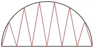

Here is another way to "see" (not construct) $e$ geometrically.
In a semicircle, draw zigzag line segments that, together with the base, form $n$ equal-width isosceles triangles whose top vertices lie on the semicircle. Here is an example with $n=6$.
$e$ is the diameter of the semicircle such that the product of the lengths of the line segments converges to a positive number as $n\to\infty$.
The limit can be expressed as $\lim\limits_{n\to\infty}\prod\limits_{k=1}^n e^2\left(\left(\frac{1}{2n}\right)^2+\frac14-\left(\frac{k}{n}-\frac{1}{2n}-\frac12\right)^2\right)$, which turns out to equal $2$.

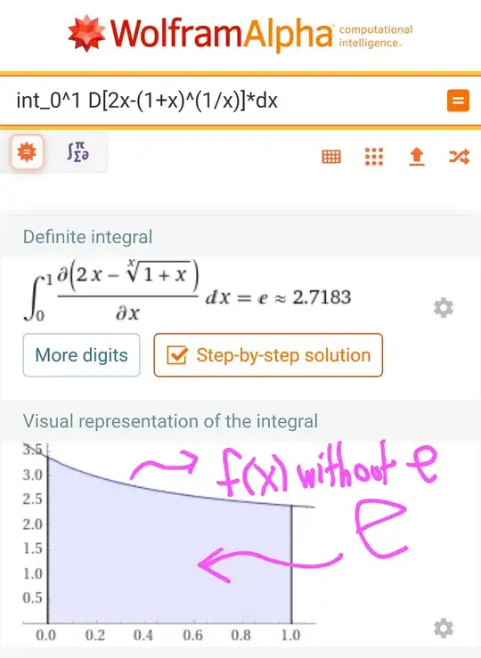

Don't knowing if this answer could met your expectatives, but I have made a similar question here, and so far I have found this:
Through the properties $\lim_{x \to 0} (1+x)^{\frac{1}{x}} = e$ and $\lim_{x \to 1} (1+x)^{\frac{1}{x}}= 2$, and using that $\log(1+x)=\int_1^{1+x} \frac{du}{u}$, you could use:
$$\int_0^1 \frac{\partial}{\partial x}\left[2x-(1+x)^{\frac{1}{x}} \right]\,dx = e$$ $$ \iff \int\limits_0^1 \left(2-(1+x)^{\frac{1}{x}}\left(\frac{1}{x(1+x)}-\frac{\log(1+x)}{x^2}\right)\right) \,dx = e$$
wolfram alpha
where the constant $e$ is not explicetly involved, but its hidden that it still requires to find the limit $\lim_{x \to 0} (1+x)^{\frac{1}{x}} = e$ so I don't know if its valid (under the integral is just a point of zero meassure, so maybe the problem is avoided, but I don't really know), but I found it interesting enough to be shared, maybe someone gets an idea to improve it.
It is possible to use also terms of the form $q(x)=\left(1+\tan\left(\frac{\pi x}{2}\right)\right)^{\cot\left(\frac{\pi x}{2}\right)}$ to find that $$\int_0^1 1-q'(x)\ dx=e$$ but is almost the same function but even more complicated, and also has the same limitations due the logarithm appearing on the derivative.
Another related ones: $$\int_0^1 \frac{\partial}{\partial x}\left[2x+(2-x)^{\frac{1}{1-x}} \right]\,dx = e$$
$$\int_0^1 \frac{\partial}{\partial x}\left[2x+\frac{1}{2}\left((2-x)^{\frac{1}{1-x}}-(1+x)^{\frac{1}{x}}\right) \right]\,dx = e$$
So at least the area below these functions adds up to $e$.

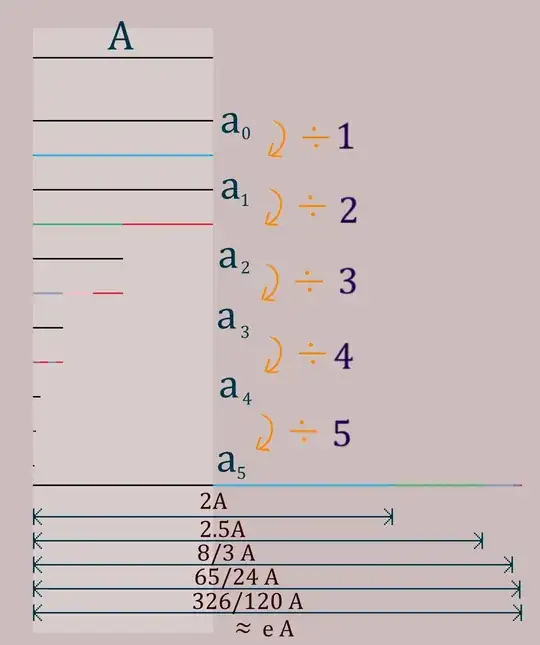

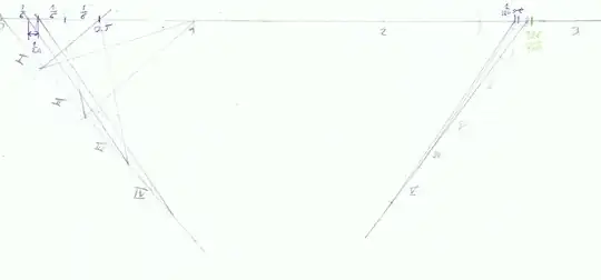

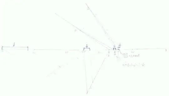

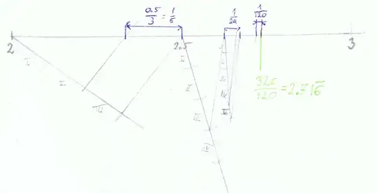

EDIT: To my answer (under the line) I am gonna add pictures I have draw- I construct an aprroximation of $e$ into 5th iteration on the Number Line, where:
$$L_0=a_0=1 $$ $$L_{n+1}=L_n+a_{n+1} ; a_{n+1}=\frac{a_n}{n+1} $$
enter image description here Altenative we can write:
$$L_2=2.5 ;a_2=0.5 $$ $$L_{n+1}=L_n+a_{n+1} ; a_{n+1}=\frac{a_n}{n+1} $$
Here I tried to approximate between $[2;3]$ (into 6th step): enter image description here enter image description here

---Introduction---
A) We gonna use the Taylor series for $e$ and multiply by $A$:
$e=1+\frac{1}{1!}+\frac{1}{2!}+\frac{1}{3!}+\frac{1}{4!}+...=1+\frac{1}{1}+\frac{1}{1*2}+\frac{1}{1*2*3}+\frac{1}{1*2*3*4}+...$
$Ae=A(1+\frac{1}{1}+\frac{1}{1*2}+\frac{1}{1*2*3}+\frac{1}{1*2*3*4}+...)$
In special case: $A=1$ (leght unit)
We can lead $Ae$ to this form:
$Ae=A(1+\frac{1}{1}(1+\frac{1}{2}(1+\frac{1}{3}(1+\frac{1}{4}(1+...)...)...)$ (Formula 1)
B) Optional: How a line segment can be devide via ruler and compass: Intercept theorem
C) (Formula 1) will be explained as an Algorithm plus picture .
---The Algorithm---
Short :
Start:
  • Have a line segment $a_0$ with a length of $A$ .
Loops:
I) Duplicate $a_{n-1}$ and divide the new segment into $n$ equal parts. Pick one element as $a_n$.
II) Add $a_{n-1}$ to the older line segments: $L_{n-1}=a_{n-1}+\displaystyle\sum_{i=0}^{n-2}a_i$
Long :
  1. Have a line segment $a_0$ with a length of $A$ .
1.1. Duplicate $a_0$ and divide the new segment into $1$ equal parts .
1.2. Pick one element as $a_1$.
1.3. Add $a_0$ to the older line segments: $L_0=a_0$
2.1. Duplicate $a_1$ and divide the new segment into $2$ equal parts .
2.2. Pick one element as $a_2$.
2.3. Add $a_0$ to the older line segments: $L_1=a_1+a_0$
3.1. Duplicate $a_2$ and divide the new segment into $3$ equal parts .
3.2. Pick one element as $a_3$.
3.3. Add $a_2$ to the older line segments: $L_2=a_2+a_1+a_0$
n.1. Duplicate $a_{n-1}$ and divide the new segment into $n$ equal parts .
n.2. Pick one element as $a_n$.
n.3. Add $a_{n-1}$ to the older line segments: $L_{n-1}=a_{n-1}+(a_{n-2}+...+a_2+a_1+a_0)$
---Picture--- enter image description here
