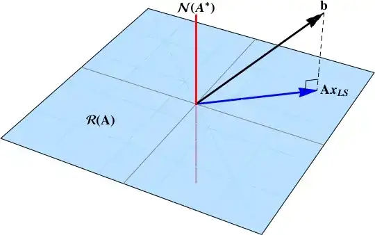

The generalized Moore-Penrose pseudoinverse can be classified by looking at the shape of the target matrix, or by the existence of the null spaces. The two perspectives are merged below and connected to left- and right- inverses as well as the classic inverse.

Only $\color{red}{\mathcal{N}_{\mathbf{A}}}$ is trivial: full column rank, row rank deficit
This is the overdetermined case, also known as the full column rank case: $m>n$, $\rho=n$. $$ \Sigma = \left[ \begin{array}{c} \mathbf{S} \\ \mathbf{0} \end{array} \right] $$ The pseudoinverse provides the same solution as the normal equations: $$ \begin{align} % \mathbf{A} & = % \left[ \begin{array}{cc} \color{blue}{\mathbf{U_{\mathcal{R}}^{*}}} & \color{red}{\mathbf{U_{\mathcal{N}}}} \end{array} \right] % \left[ \begin{array}{c} \mathbf{S} \\ \mathbf{0} \end{array} \right] % \color{blue}{\mathbf{V_{\mathcal{R}}}} \\ % Apinv \mathbf{A}^{\dagger} & = % \color{blue}{\mathbf{V_{\mathcal{R}}}} \, \left[ \begin{array}{cc} \mathbf{S}^{-1} & \mathbf{0} \end{array} \right] % \left[ \begin{array}{c} \color{blue}{\mathbf{U_{\mathcal{R}}^{*}}} \\ \color{red}{\mathbf{U_{\mathcal{N}}^{*}}} \end{array} \right] \end{align} $$ The inverse from the normal equations is $$ \begin{align} \left( \mathbf{A}^{*}\mathbf{A} \right)^{-1} \mathbf{A}^{*} &= % \left( % \color{blue}{\mathbf{V_{\mathcal{R}}}} \, \left[ \begin{array}{cc} \mathbf{S} & \mathbf{0} \end{array} \right] % \left[ \begin{array}{c} \color{blue}{\mathbf{U_{\mathcal{R}}^{*}}} \\ \color{red}{\mathbf{U_{\mathcal{N}}^{*}}} \end{array} \right] % A \left[ \begin{array}{cx} \color{blue}{\mathbf{U_{\mathcal{R}}}} & \color{red}{\mathbf{U_{\mathcal{N}}}} \end{array} \right] \left[ \begin{array}{c} \mathbf{S} \\ \mathbf{0} \end{array} \right] \color{blue}{\mathbf{V_{\mathcal{R}}^{*}}} \, % \right)^{-1} % A* % \left( \color{blue}{\mathbf{V_{\mathcal{R}}}} \, \left[ \begin{array}{cc} \mathbf{S} & \mathbf{0} \end{array} \right] % \left[ \begin{array}{c} \color{blue}{\mathbf{U_{\mathcal{R}}^{*}}} \\ \color{red}{\mathbf{U_{\mathcal{N}}^{*}}} \end{array} \right] \right) \\ \\ % &= % \color{blue}{\mathbf{V_{\mathcal{R}}}} \, \left[ \begin{array}{cc} \mathbf{S}^{-1} \, \mathbf{0} \end{array} \right] % \left[ \begin{array}{c} \color{blue}{\mathbf{U_{\mathcal{R}}^{*}}} \\ \color{red}{\mathbf{U_{\mathcal{N}}^{*}}} \end{array} \right] \\ % &= \mathbf{A}^{\dagger} % \end{align} $$ The figure below shows the solution as the projection of the data vector onto the range space $\color{blue}{\mathcal{R}(\mathbf{A})}$.

This is an underdetermined case, also known as the full row rank case: $m<n$, $\rho=m$. We lose uniqueness and the solution will be an affine space. $$ \Sigma = \left[ \begin{array}{cc} \mathbf{S} & \mathbf{0} \end{array} \right] $$ The target matrix and pseudoinverse are: $$ \begin{align} % \mathbf{A} & = % \color{blue}{\mathbf{U_{\mathcal{R}}}} \, \left[ \begin{array}{cc} \mathbf{S} & \mathbf{0} \end{array} \right] % \left[ \begin{array}{c} \color{blue}{\mathbf{V_{\mathcal{R}}^{*}}} \\ \color{red} {\mathbf{V_{\mathcal{N}}^{*}}} \end{array} \right] % \\ % Apinv \mathbf{A}^{\dagger} & = % \left[ \begin{array}{cc} \color{blue}{\mathbf{V_{\mathcal{R}}}} & \color{red} {\mathbf{V_{\mathcal{N}}}} \end{array} \right] \left[ \begin{array}{c} \mathbf{S}^{-1} \\ \mathbf{0} \end{array} \right] % \color{blue}{\mathbf{U_{\mathcal{R}}^{*}}} % \end{align} $$ The inverse matrix is $$ \begin{align} \mathbf{A}^{*} \left( \mathbf{A} \, \mathbf{A}^{*} \right)^{-1} % &= % \left[ \begin{array}{cc} \color{blue}{\mathbf{V_{\mathcal{R}}}} & \color{red} {\mathbf{V_{\mathcal{N}}}} \end{array} \right] \left[ \begin{array}{c} \mathbf{S}^{-1} \\ \mathbf{0} \end{array} \right] % \color{blue}{\mathbf{U_{\mathcal{R}}^{*}}} \\ % &= \mathbf{A}^{\dagger} % \end{align} $$
The least squares solution is the affine space $$ \begin{align} x_{LS} = \color{blue}{\mathbf{A}^{\dagger} b} + \color{red}{ \left( \mathbf{I}_{n} - \mathbf{A}^{\dagger} \mathbf{A} \right) y}, \qquad y \in \mathbb{C}^{n} \\ \end{align} $$ represented by the dashed red line below.

The matrix $A$ typically has many more rows than columns --- lets imagine $200$ rows and $3$ columns. The $200\times1$ vector $b$ is typically not in the column space of $A$, so the equation $Ax\overset{\Large\text{?}}=b$ has no solution for the $3\times1$ vector $x$. The problem is to find the value of $x$ that makes $Ax$ as close as possible to $b$, in that $\|Ax-b\|$ is as small as possible. The solution is the orthogonal projection of $b$ onto the column space of $A$. The entries in $x$ are the coefficients in a linear combination of the columns of $A$.
