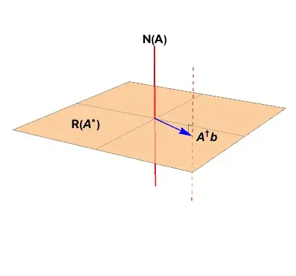

Geometrically, the issue is shown below. The general least squares solution is the affine space represented by the red, dashed line.
  1. If the $\color{red}{null}$ space is trivial, $\color{red}{\mathcal{N} \left( \mathbf{A} \right)} = \mathbf{0}$, the least squares solution is the point $\color{blue}{\mathbf{A}^{+}b}$ in the $\color{blue}{range}$ space $\color{blue}{\mathcal{R} \left( \mathbf{A}^{*} \right)}$.
  2. If the $\color{red}{null}$ space is not trivial, $\color{red}{\mathcal{N} \left( \mathbf{A} \right)} \ne \mathbf{0}$, the least squares solution is the affine space going through the point $\color{blue}{\mathbf{A}^{+}b}$ in $\color{blue}{range}$ space $\color{blue}{\mathcal{R} \left( \mathbf{A}^{*} \right)}$ and extending through the $\color{red}{null}$ space.
affine
Least squares solution
Given a matrix $\mathbf{A}\in\mathbb{C}^{m\times n}_{\rho}$, and a data vector $b\in\mathbb{C}^{m}$ such that $$ b\notin\color{red}{\mathcal{N} \left( \mathbf{A} \right)} $$ The least squares solution is defined as $$ x_{LS} = \left\{ x\in\mathbb{C}^{n} \colon \lVert \mathbf{A} x - b \rVert_{2}^{2} \text{ is minimized} \right\} $$ The least squares solution is computed using
$$ x_{LS} = \color{blue}{\mathbf{A}^{+} b} + \color{red}{ \left( \mathbf{I}_{n} - \mathbf{A}^{+} \mathbf{A} \right) y}, \quad y \in \mathbb{C}^{n} $$ In this form, it's clear that having a unique solution demands $$ \mathbf{A}^{+} \mathbf{A} = \mathbf{I}_{n} $$ which happens when $\color{red}{\mathcal{N} \left( \mathbf{A} \right)} = \mathbf{0}$. More details are in the subsequent links.
