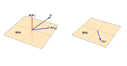

Geometric view:
• If the data vector has a $\color{red}{null}$ space component, there is no direct solution, and we must use least squares.
• If the data vector is in the column space, an exact solution exists; there is a direct solution. geometric view
Unique solution, not exact: $\lVert \mathbf{A}x - b\rVert > 0$
The data vector has components in both the $\color{blue}{range}$ and $\color{red}{null}$ spaces: $$ b = \color{blue}{b_{\mathcal{R}}} + \color{red}{b_{\mathcal{N}}} $$ The data vector cannot be expressed entirely in terms of combinations of the columns of the matrix $\mathbf{A}.$ The method of least squares is used to find the best approximation. This is the orthogonal projection of the data vector onto $\color{blue}{\mathcal{R} \left( \mathbf{A} \right)}$; the "shadow" of the data vector. In one of the follow on posts mentioned below, we see that the sum of the squares of the residual errors measures the amount of the data vector in $\color{red}{\mathcal{N} \left( \mathbf{A}^{*} \right)}$. The least squares solution is $$ \color{blue}{x_{LS}} = \color{blue}{\mathbf{A}^{+}b} $$
