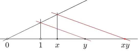

You can do so, but if you want to represent the result of the multiplication again as a length you have to choose a unit. The ancient Greeks didn't come up with this idea; whence their products were always areas.
Responding to temo's comment: When the point $O\in g$ representing the number $0$ has been chosen the geometric construction for the sum of two numbers is scale invariant, as a consequence of $(\lambda x)+(\lambda y)=\lambda(x+y)$; but a similar identity for multiplication does not hold: $(\lambda x)\cdot(\lambda y)\ne\lambda(x\cdot y)$. You can test the effect in the figure by keeping $x$ and $y$ but choosing a new unit $1'$. The point $xy$ will now be at a different location.

    Beautiful! But now I'm a little bit confused: What is the underlying cause that enables us to do addition without the choice of a unit, but not multiplication ? – temo May 01 '12 at 13:12
    I saw this come up before when doing constructions with ruler and compass but didn't understand why a unit had to be picked until I thought about it in terms of groups. It's necessary because a priori we don't know if $x$ is bigger or smaller than the multiplicative identity, or unit. Let us consider only positive numbers for now. If $x$ is bigger than the unit, then multiplication by $x$ must make the number bigger. Likewise, if it is smaller, multiplication makes the number smaller. For addition, the identity of the group is 0 and it is easier to say in some sense a number's relation to 0. – Steven-Owen May 01 '12 at 19:10

  • Thanks for the answer! Any chance you elaborate on this a little, esp. how the black line is chosen, and order of operations? Thanks!! – Matifou Apr 21 '17 at 01:33
  • @Matifou: Take any line through $O$ different from the "number line". – Christian Blatter Apr 21 '17 at 07:58
    Thanks! Is it then 1) Take any line 2) get the intersection point between that line and the vertical line above 1 3) get the intersection point between the vertical line above x 4) draw a line point in 2 till y 5) draw a line from point in 3, parallel to line drawn in 4? Or am I missing/confusing something? – Matifou Apr 21 '17 at 16:41
  • @Matifou: That's it. It's all about intercept theorems, or similar triangles. – Christian Blatter Apr 21 '17 at 18:10
    This can be extended to division. If you were to replace $1$ in your diagram by $l$ (lower case L) then your length left-to right would be $\dfrac{xy}{l}$ – Henry Dec 20 '17 at 08:32
