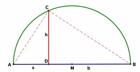

There is a better way, I think. First, you have to be given a segment of unit length, otherwise multiplication doesn't make sense. Now if you have $a$ and $b$, you can construct $h$ so that $h^2=a\cdot b$, using the geometric mean theorem. After that, you use the same $h=CD$ and your unit segment $1$ to find the $x$ satisfying $h^2=x\cdot1$: the unit segment is then $DB$, you find the circle with midpoint $M$ on the line through $B$ and $D$ ($M$ is where the perpendicular bisector of $BC$ hits the line through $D$ and $B$), the circle will have a second intersection point $A$ with the line through $BD$, so $x=a\cdot b/1$ will be $AD$.
  • Sorry, I did not understand this last part "just taking the unit segment as segment b, finding M, the resulting segment a will be our x." So I have to draw another real line with a different scale (unit segment on the new real line is the b segment on the old real line), and then...? Why is point M important for me? –  Oct 01 '17 at 11:34
  • @Biagio Ianero I've added a few details, is it more understandable, now? –  Oct 01 '17 at 11:51
  • Yes, thank you. I've also replied for adding the construction of the inverse, and so now one can geometrically build the number a/b. –  Oct 02 '17 at 08:12
