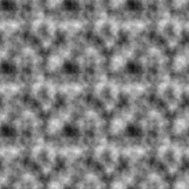

Ok, I got it. The answer is to walk in a torus in 3D noise, generating a 2D texture out of it.
torus wraps 2 dirs
Code:
Color Sky( double x, double y, double z )
  // Calling PerlinNoise3( x,y,z ),
  // x, y, z _Must be_ between 0 and 1
  // for this to tile correctly
  double c=4, a=1; // torus parameters (controlling size)
  double xt = (c+a*cos(2*PI*y))*cos(2*PI*x);
  double yt = (c+a*cos(2*PI*y))*sin(2*PI*x);
  double zt = a*sin(2*PI*y);
  double val = PerlinNoise3D( xt,yt,zt, 1.5, 2, 12 ) ; // torus
  return val*val*cloudWhite + 2*val*(1-val)*gray + (1-val)*(1-val)*skyBlue ;
Results:
Once:
tilable sky
And tiled:
showing it tiles

You use a modular wrap around for each scale of the noise. These fit the edges of the area no matter what frequency scale you use. So you only have to use normal 2D noise which is a lot faster. Here is the live WebGL code which can be found at ShaderToy: https://www.shadertoy.com/view/4dlGW2
The top three functions do all the work, and fBM is passed a vector x/y in a 0.0 to 1.0 range.
// Tileable noise, for creating useful textures. By David Hoskins, Sept. 2013.
// It can be extrapolated to other types of randomised texture.
#define SHOW_TILING
#define TILES 2.0
float Hash(in vec2 p, in float scale)
    // This is tiling part, adjusts with the scale...
    p = mod(p, scale);
    return fract(sin(dot(p, vec2(35.6898, 24.3563))) * 353753.373453);
float Noise(in vec2 x, in float scale )
    x *= scale;
    vec2 p = floor(x);
    vec2 f = fract(x);
    f = f*f*(3.0-2.0*f);
    //f = (1.0-cos(f*3.1415927)) * .5;
    float res = mix(mix(Hash(p,                  scale),
        Hash(p + vec2(1.0, 0.0), scale), f.x),
        mix(Hash(p + vec2(0.0, 1.0), scale),
        Hash(p + vec2(1.0, 1.0), scale), f.x), f.y);
    return res;
float fBm(in vec2 p)
    float f = 0.4;
    // Change starting scale to any integer value...
    float scale = 14.0;
    float amp = 0.55;
    for (int i = 0; i < 8; i++)
        f += Noise(p, scale) * amp;
        amp *= -.65;
        // Scale must be multiplied by an integer value...
        scale *= 2.0;
    return f;
void main(void)
    vec2 uv = gl_FragCoord.xy / iResolution.xy;
#ifdef SHOW_TILING
    uv *= TILES;
#endif
    // Do the noise cloud (fractal Brownian motion)
    float bri = fBm(uv);
    bri = min(bri * bri, 1.0); // ...cranked up the contrast for no reason.
    vec3 col = vec3(bri);
#ifdef SHOW_TILING
    vec2 pixel = (TILES / iResolution.xy);
    // Flash borders...
    if (uv.x > pixel.x && uv.y > pixel.y                                        // Not first pixel
    && (fract(uv.x) < pixel.x || fract(uv.y) < pixel.y) // Is it on a border?
    && mod(iGlobalTime-2.0, 4.0) < 2.0)                 // Flash every 2 seconds
        col = vec3(1.0, 1.0, 0.0);
#endif
    gl_FragColor = vec4(col,1.0);
Pikalek
  • 12,372
  • 43
  • 51

    Your image link went dead. I took a best guess & replaced it with a screen shot of the output from the shadertoy code you posted. If that's not correct, please re-upload your intended image directly to the Stack Exchange server. – Pikalek Aug 22 '18 at 14:26
