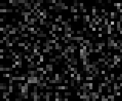

I'm toying with Perlin Noise after some work with Diamond Square. I followed the implementation by Hugo Elias that basically, makes a series of functions with x,y as input to throw each coordinate value.
My PHP code is here:
I have two questions:
How do I use the algorithm to generate a height map in an array? I did not fully understand it and just ported to PHP the pseudocode, but doing the last function (map_perlined) after reading somewhere that the algorithm "magically" gives you transitioned values for each x,y point given (apparently, without having to read its adjacent values), I just get this when using as random function mt_rand(-100,100)/100;
And this when using the cryptographic: 1.0-(($n*($n*$n*15731+789221)+1376312589)&0x7fffffff)/1073741824.0; (which, BTW, can be implemented "as-is" in PHP?):
So, summing up, three questions:
  1. Is my code correct?
  2. The random function can be ported to PHP as described in the code? It throws no errors, but the results are not there.
  3. How do I actually use the algorithm?

More Perlin work. I have yet to find a way to guide the noise to my results. Check these octaves and the final result:
Octave I to IV
Octave1Octave2Octave3Octave4
Summed up
Octaves 1-4 summed
Each octave is pretty much the same. Check the code:
$persistence = 0.5;
    for ($j = 0; $j < $size; $j++) {
      for ($i = 0; $i < $size; $i++) {
        $value = 0;
        for ($o = 0; $o < 4; $o++) {
          $frequency = pow(2,$o);
          $amplitude = pow($persistence, $o);
          $value += improved_noise($i*$frequency, $j*$frequency, 0.5)*$amplitude;
        $this->map[$i][$j] = new Cell($value);
The results are normalized. What would you use have a strong influence in the development of the noise? I see examples where changing the amplitude gives soft or rough surfaces, but even if I give a huge amplitude, I see little difference.

What you implemented isn't Perlin noise. I'm not sure why Hugo Elias says it is, but he's confused. Here is Ken Perlin's reference implementation. It doesn't actually call any external random number generator, but uses a built-in hash function to produce the pseudorandom gradient vectors.
Note also that Perlin noise consists of just one octave. Summing up multiple octaves (scaled instances of the noise function), as Hugo Elias suggests, is a useful technique, but not part of Perlin noise. What you get by doing that is called fractal noise, sometimes "fractal Brownian noise" (because of the supposed similiarity to Brownian motion).
If you want to understand geometrically what the algorithm is doing, try this paper. It's about a different kind of noise called "simplex noise", but also includes an explanation of classic Perlin noise. Incidentally, simplex noise was also invented by Perlin and is supposed to be an improvement over his classic noise, so you might try implementing it too if you're interested in playing with noise functions.

That's a common misconception. What Hugo Elias calls "Perlin" noise is in fact fractal, or pink, noise. To better understand what Perlin noise is, you can read Perlin's article linked in Nathan Reed's answer, or libnoise docs (there's the same error there: Perlin noise is what they call Gradient noise), or CoherentNoise docs.
Now, to actually answer your question: you didn't get the expected result because noise frequency is too high. Your frequencies start with 1 and increase, meaning that every pixel in the resulting map has a random value. To see finer structure of the map, you need to "zoom in" on the noise. I don't really speak PHP, but I suppose the code should look like this:
$arrayMap[$i][$j] = PerlinNoise_2D($i/$width, $j/$height, $p, $octaves);
That is, you "stretch" one period of noise over your entire map. Of course, you can use other coefficients - just try different ones, see what happens.
