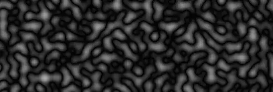

I'm looking to generate noise that looks like this:
enter image description hereenter image description here
(images courtesy of Understanding Perlin Noise)
I'm basically looking for noise with lots of small "ripples". The following is undesirable:
Are there any simple ways to do this? I've been looking at perlin and simplex for a week now and I can't seem to ever get it to work in JavaScript, or when I do, I don't have the correct parameters to generate such images, or it is excruciatingly slow.
I understand that the 3 images I posted could probably be achieved by the same algorithm but at a different scale, but I don't need that algorithm. I just need a very simple algorithm to achieve something like in the first image ideally. Maybe some kind of blurring would do the job, but I can't manage to have results.
I'm developing this in JavaScript but any kind of code or even a simple and detailed explanation will work.

While the existing answers provide a good way to achieve what the images in the question show, the comments revealed that the goal is to generate an image as shown below:
perlin noise turbulence
This type of noise is quite different from the noise shown in the images of the question, as it forms close isolated blobs.
Turns out that this kind of noise is called turbulence which (according to this CPU Gems article) is implemented as follows (where noise is your Perlin-noise function returning values from -1..1):
double turbulence(double x, double y, double z, double f) {
    double t = -.5;
    for ( ; f <= W/12 ; f *= 2) // W = Image width in pixels
        t += abs(noise(x,y,z,f) / f);
    return t;
When you get 2D noise from an existing Perlin-noise implementation, you can just use the abs value of the noise to get the desired turbulence noise.
turbulence noise
The JavaScript code that was used to generate the image above can be found in this jsFiddle.

Your example images look a lot like pink noise. It is generated like this:
  • First, we have some sort of smooth random noise. Usually, this is achieved by calculation pseudo-random values at points with integer coordinates, and the interpolating these values somehow. The result at this stage looks like this:
  • Next, we take this noise and "squeeze" it, increasing its frequency. The simplest formula for this is n2(x,y)=n1(xf,yf). In this way, noise pattern is squeezed f times in both directons. Better noise algorithms also rotate and/or translate noise pattern at this step, in order to break up regularities.
  • Then, this squeezed pattern is multiplied by some value (less than 1) and added to first pattern. In effect, we add small higher-frequency variation on top of low-frequency pattern. The result looks kinda like this:
  • Steps 2 and 3 may be repeated a number of times, adding finer and finer detail. the net result usually looks just like your example with the red cross. However, notice that we have 3 parameters in our algorithm to play with:
    • Octave count - or, in other words, number of steps in generation. More steps means finer detail in the resulting pattern.
    • Persistence. It's that value that is multiplied in every step. Usually, persistence is between 0 and 1. High persistence values usually produce "noisy" patterns with lots of little detail. Low persistence creates smooth patterns with subtle detail.
    • Lacunarity. It's the "squeeze" coefficient we use every step. Lacunarity works a bit like peristence, but not exactly. Low lacunarity produces smoother patterns, and high lacunarity creates more sharp and high-contrast ones.
