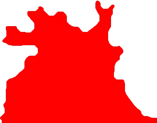

I'm working on a Worms-styled game and want to generate some terrain procedurally. I've previously done a lot of terrain generation using perlin noise, and this is what I started out using for this game. The only problem with it is that it's too simple and boring, giving me some hills but not the complexity I want. I'd like to have features like caves and hanging mountains and I don't mind floating islands and such. Something like this, but even crazier would be ok:

  • Does the red represent caves or is that just part of the terrain? – Richard Marskell - Drackir Dec 05 '11 at 15:04
  • It's part of the terrain. I just Google that image, was the closest to what I want to accomplish. The "cave" part might be that little hole to the right, if it was continued more inside the terrain to it's left. – Xeon06 Dec 05 '11 at 15:12
  • @Drackir, edited the image. – Xeon06 Dec 05 '11 at 15:16

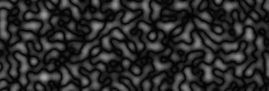

I'd suggest you start with 2D Perlin-noise. Something like this:
perlin-noise

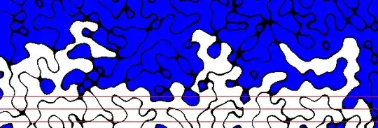

Then apply a threshold on the image, so that you get several isolated islands, as shown here:
perlin noise with threshold
I chose a threshold of 0.04, everything above the threshold would be colored blue. The rest remaining black. Then after that, it's time to determine which "islands" to keep and which to throw away.
A possible approach would be to run through the image from left to right at various heights and select intersecting "islands" given a certain probability. In the example picture, the lowest line has a probability of 100%, so every island it crosses will be selected (filled white). The second line has a probability of 50% and the topmost line has a probability of 10%.

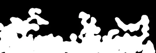

dilated islands
And there's a possible landscape.

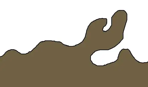

And this is an example of the result: example of generated terrain
I wrote a detailed article about the whole process here and the code(JavaScript) is open source, check it out if you want something ready to use ;)
