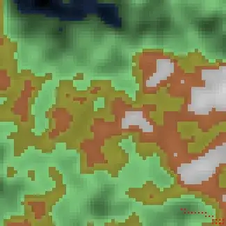

Managed to get something like this using a simplexnoise port i made from the original javacode to php:
Used some tips from other post:
Understanding Perlin Noise
basically, lowered the frequency to get more flat terrain.
Now, how could i foce the map to be a huge Pangea? If i manualy set for example, if (x < 5) set height = 0 (water), when i normalize all the map to 0...1 the value 0 get higher (as my simplexnoise function returns -1 1). If i force it to -9999, does not work either.
Has to me something elegant to sneak into the height generation code to make the borderline squares, water.
With MDP algorithm i could seed the sides of the map to -500 for example and then pretty coast would be made, but with simplex/perlin does not seem the case as i can not enter pre-seeded cells with artificial heights.
Any tips?

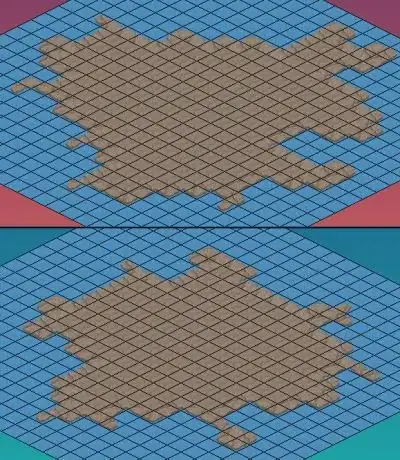

Some aditional ideas... last time I generated something like this, I used probabilities and a random number generator.
I simply choose the center of my island, and a maximum radius. Then for each pixel, there was a probability of it being land or water based on its distance from the center and the maximum radius. At the end I also applied a few post processing passes, to detect oceans and remove inner lakes, etc.
Maybe you could keep your current simplex noise approach, but afterwards do a similar post-process on your map in order to make it more "continent-like".
This could consist of going through every pixel, and depending on a random probability convert some of them back to water (by setting the value to 0) e.g. 100% chance of water at the border and decrease to 0% about 20 pixels in). This way it would still look kinda organic.
You could then apply a second pass to remove small islands or something, if you wanted.
Just for reference, using probabilities generates shapes such as this (of course this is in a much lower resolution that yours because it's tile based, not pixel based):

  • I dont think i will get good results with your binary and probabilistic method, as the mountails will go to the edge of the island which is unrealistic. But stupidly never tried to filter the values after the normalization, i'll give it a try! haha. This happens when you program late in the night after long work hours >_< – Gabriel Dec 16 '11 at 18:31
