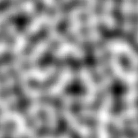

I need to generate something like this
for my water Shader, because on fly calculations are to expensive for mobile (https://docs.unity3d.com/Packages/[email protected]/manual/Gradient-Noise-Node.html). The texture needs to be seamless. I currently clueless where and how to make this happen (especially about the seamless thing). Any help appreciated!

  • Presumably you searched through past Q&A on making tiling Perlin or Simplex Noise? What have you tried based on your research so far? – DMGregory Jun 02 '20 at 20:08
  • Reading trough this https://gamedev.stackexchange.com/questions/23625/how-do-you-generate-tileable-perlin-noise . I do not quite understand if gradient noise is same as Perlin. – Janis Taranda Jun 02 '20 at 20:10
  • Gradient noise is a general category of noise generation strategies. Perlin Noise and Simplex Noise are two popular and related algorithms that use this gradient-based strategy. Perlin is arguably a bit easier to tile in a rectangular domain, since simplex noise uses an equilateral triangular grid whose period parallelogram doesn't exactly match a power-of-two texture size. – DMGregory Jun 02 '20 at 20:12
