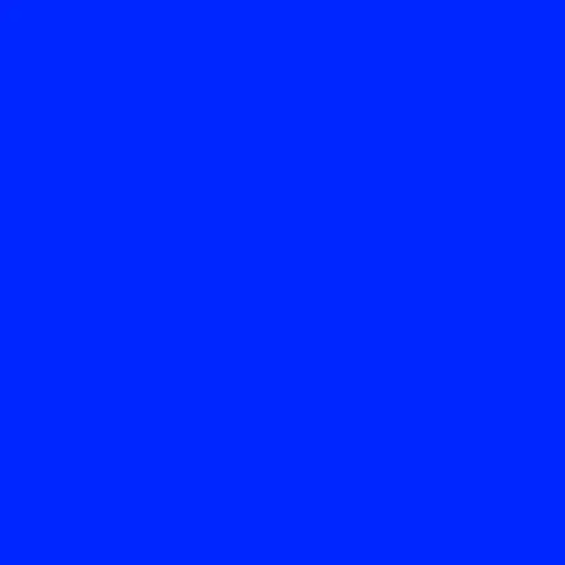

This is the result that I get: enter image description here
What am I doing wrong? How can I fix this?
  • What type are x and xsize? Could there be integer division happening? –  May 27 '18 at 10:32
  • yep it was because they were integers. thx for helping. but do you also know how i can increase the scale becouse i cant use my old scale formula on this. – yente paternotte May 27 '18 at 12:48
  • Note that while 2D Perlin/Simplex noise is band-limited, a 2D slice through a higher-dimensional noise as suggested here is not. You tend to get frequency leakage that makes it more like white noise. If band limitation is important to your use of noise, we can construct a natively tiling 2D noise. Or is the cylindrical slice through 3D noise sufficient for your needs? – DMGregory May 27 '18 at 13:22
Your x / xsize and y / ysize use integer division and return incorrect values because of that.
