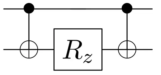

Here $R_z$'s argument is $-2t$ ($R_z(-2t) = e^{i\sigma_z t}$). Before showing why this is true let's introduce 2 formulas that we will us. 4.2 exercise from the textbook [2]: Let $t$ be a real number and $A$ a matrix such that $A^2 = I$. Then
$$e^{iA t} = \cos(t) I + i \sin(t) A$$
For all Pauli terms, this $P_k^2 =I$ is true. So we can use this formula. For CNOT gate we have:
$$\mathrm{CNOT} = |0\rangle \langle 0 | \otimes I + |1\rangle \langle 1 | \otimes \sigma_x$$
By taking these formulas into account let's show that the circuit implements the $e^{i \sigma_z \otimes \sigma_z t}$ Pauli term:
\begin{align*} e^{i \sigma_z \otimes \sigma_z t} = \cos(t) I + i \sin(t) \sigma_z \otimes \sigma_z \end{align*}
The circuit:
\begin{align*} &\mathrm{CNOT} \left(I \otimes e^{i \sigma_z t}\right) \mathrm{CNOT}= \big[|0\rangle \langle 0 | \otimes I + |1\rangle \langle 1 | \otimes \sigma_x \big] \\ &\big[ \cos(t) I\otimes I + i \sin(t) I \otimes \sigma_z \big] \big[|0\rangle \langle 0 | \otimes I + |1\rangle \langle 1 | \otimes \sigma_x \big] = \\ &= \cos(t) I + i \sin(t) \sigma_z \otimes \sigma_z \end{align*}
So, the circuit implements what we want:
$$ e^{i \sigma_z \otimes \sigma_z t} =\mathrm{CNOT} \left(I \otimes e^{i \sigma_z t}\right) \mathrm{CNOT} $$

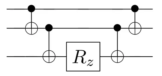

The circuit for the $e^{i \sigma_z \otimes \sigma_z \otimes \sigma_z t}$ Pauli term from the same paper [1]:
This also can be shown the same way. Moreover, this solution can be generalized for $e^{i \sigma_z \otimes \sigma_z \otimes ... \otimes \sigma_z t}$ Pauli term.
