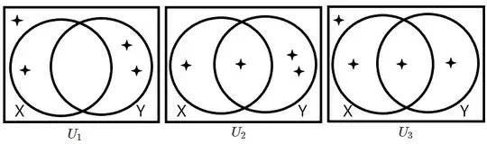

Independence of events is not straightforward to intuit from Venn diagrams (unlike mutual exclusivity, which is observed by inspecting their intersection).
For example: enter image description here
$$ \begin{array}{r} \begin{array}{c|c|c} \style{font-family:inherit}{} & \style{font-family:inherit}{U_1} & \style{font-family:inherit}{U_2} & \style{font-family:inherit}{U_3} \\\hline \style{font-family:inherit}{P(X\cap Y)} & 0 & \frac14 & \frac14 \\[0pt]\hline \style{font-family:inherit}{P(X)P(Y)} & \frac14\times\frac12=\frac18 & \frac14\times\frac34=\frac38 & \frac12\times\frac12=\frac14 \\[0pt]\hline \style{font-family:inherit}{\therefore X\text{ and }Y\text{ are}\ldots} & \textbf{dependent} & \textbf{dependent} & \textbf{independent} \end{array}\hskip-5.5pt \end{array} $$ [Universe $U_1$ above is also an example of the fact that for events with nonzero probabilities, $\big(\text{mutual exclusivity}\implies\text{dependence}\big)$.]

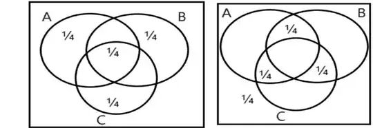

Two more examples, but involving $3$ events: in each case, events $A,B$ and $C$ are pairwise independent yet are not (mutually) independent $\big($since $P(A \cap B\cap C) \neq P(A)P(B)P(C)\,\big):$ enter image description here
In the above universe, $a,b,c$ and $d$ denote probabilities associated with events $X$ and $Y.$ \begin{align}&\text{events }X \text{ and } Y \text{ are }\textbf{independent} \\\iff &P(X\cap Y)=P(X)P(Y) \\\iff &\frac{c}{a+b+c+d}=\frac{b+c}{a+b+c+d}\times\frac{c+d}{a+b+c+d} \\\iff &ac=bd.\end{align}
In particular, for the OP's given scenario, since $\left(\frac{16}{25}\right)\left(\frac{1}{25}\right)\neq\left(\frac{0}{25}\right)\left(\frac{8}{25}\right),$ events $A$ and $B$ are dependent.

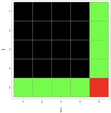

Don't use Venn. Consider instead this table:
If you're in the red, what is the probability you're in the green (overlapping red) region?
Clear?
  • Why is 1 to 5 all green? for a first and second toss? –  Aug 16 '21 at 13:03
  • A 5 on the first toss (i) or a 5 on the second toss (j). – David G. Stork Aug 16 '21 at 16:07
    Oh. Isn't it all green because those are all the combinations that have a 5 in it? (i.e., 1 5, 5 1, 2 5, etc.? And 5 is red because that is the situation where the tosses are 5 5? –  Aug 16 '21 at 16:15
  • The green are where there is a 5 on EITHER the first toss OR the second toss. The red is where the is a 5 on BOTH the first toss AND the second toss. Clear? – David G. Stork Aug 16 '21 at 16:17
    Yes. I believe that is what I said but I said it slightly more unclear? lol –  Aug 16 '21 at 16:18
