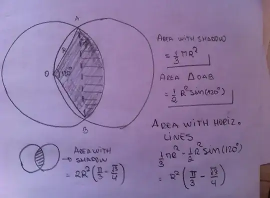

We can build an Equilateral triangle between the points, whose side length is $r$:
pic
picture source
So we know that the points of intersection are $\sqrt{3}r$ apart, and the angle at them is $60^\circ$, by building a rhombus between the dots and centers we know that the angle that "opens" the area is $120^\circ$: enter image description here
We can now calculate half the area in question as a circular segment:
$$S=2\left[\frac{r^2}{2}\left(\frac{2\pi}{3}-\sin\left(\frac{2\pi}{3}\right)\right)\right]=r^2\left(\frac{2\pi}{3}-\frac{\sqrt{3}}{2}\right)$$
$S$ is the total area in question
