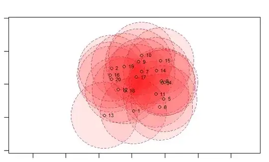

20 points, installing a transmitter in each, shading their coverage areas in transparent red:
You can clearly see that there is a lot of overlap.

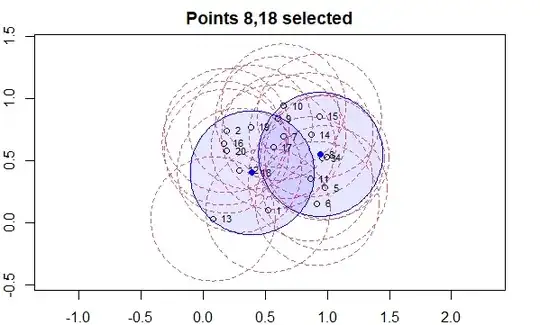

Selecting only the points in blue, shading the union of their coverage area in transparent blue, overlaid with the union of the full coverage area in red:
This does not do too bad a job, using only 5 out of 20 transmitters, but it leaves a substantial area on the top-right uncovered.
And it does not seem to be an 'optimal' solution: everything else being equal, 15 would have been preferable to 7, as the latter is already in a 'crowded' area.

It works, as far as the goal of covering the initial points is concerned, and in this sense I find it a very interesting result, possibly of use in some contexts.
[BTW the code can surely be improved, too; I really went for the easiest path, no attempt to make any elegant or fast implementation].
However, clearly this does not cover anything close to the whole area that would be covered by all the circles, by far:

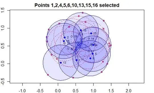

EDIT 2: implementation of the binary LP set cover with auxiliary points
It seems to work.
The auxiliary points are in red in the plot below. I found them by intersecting each circle with the line by its centre and the centroid, and keeping the intersection farther away from the centroid (in fact now I wonder if I should also keep the one closest to the centroid; or indeed as RobPratt commented, sampling the circumferences; but OK, for further development).
By including these points, the whole area is covered (at least in this example), and this highlights something I find very interesting: some very close centres are selected, because without them some areas would be left uncovered - but that also means that the p-dispersion approach would probably not be effective, as it would first and foremost try and keep the selected centres far apart(!).
Overall I like this result, so thanks again RobPratt for your input, you helped me think this through and reach what seems to me a rather satisfactory solution!
