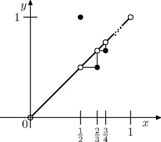

Try something like the function in the following picture:
If you only have to show that such bijection exists, you can use Cantor-Bernstein theorem and $(0,1)\subseteq (0,1] \subseteq (0,2)$. See also open and closed intervals have the same cardinality at PlanetMath.
