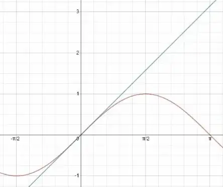

May be you can prove the fact by finding the area under the curve of each function.
Assuming $\epsilon$ to be a very small and nearly zero in value, the area of $\sin(x)$ in the desired interval is approximately is
$A1=\int_{0+\epsilon }^{\pi/2 - \epsilon }\sin(x)dx = \cos(0+\epsilon )-\cos(\pi/2 - \epsilon ) \approx \cos(0)-\sin(\epsilon )\approx 1$
The area under the line $y=x$ for the same interval is:
$A2=\int_{0+\epsilon }^{\pi/2 - \epsilon} x dx = \frac{1}{2}(\pi/2-\epsilon )^2 - \epsilon ^2) \approx1.23$
Since A1 < A2, we can say that:
$\sin x<x\,(0<x<\frac{\pi}{2})$
