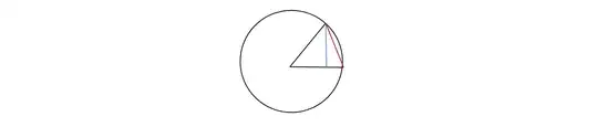

There are many analytical ways of solving this, my favourite being the comparison of derivatives.
Geometrically you can argue that $\sin t$ (blue segment) is shorter than red which is shorter than an arc of length $t$:
A geometric argument
(This works for $t < \pi/2$, what includes $t=1$ which is the maximal value of $\sin t$).
