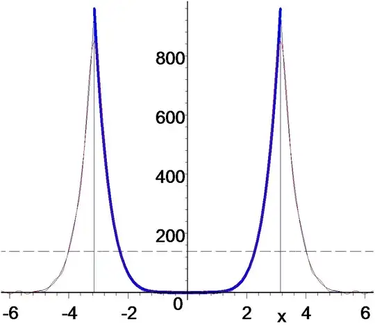

I have posted here in Portuguese a recursive method based on the computation of the Fourier trigonometric series expansion for the function defined in $\left[ -\pi ,\pi \right] $ by $f(x)=x^{2p}$ and extended to all of ${\mathbb R}$ periodically with period $2\pi.$ This is a shorter description than the original. In this reply I outline the case $\zeta(4)$. For $p=3$ the expansion is
$$x^{6}=\dfrac{\pi ^{6}}{7}+2\displaystyle\sum_{n\ge 1}^{}\left( \left( \dfrac{6}{n^{2}}\pi ^{4}-\dfrac{120}{n^{4}}\pi ^{2}+\dfrac{720 }{n^{6}}\right)\cos n\pi \right) \cos nx.\tag{1}$$

Plots of the periodic function defined in $\left[ -\pi ,\pi \right] $ by $f(x)=x^{6}$ (blue curve) and of the partial sum with the first 10 terms of its Fourier trigonometric series (red curve).
