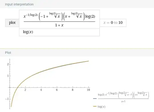

In this other question I found an approximation as follows: $$\ln(x+1) \approx \dfrac{\ln(x)}{1-x^{-\frac{1}{\ln(2)}}}$$
By differentiating both sides, since just one logarithmic terms remains you could find the following approximation: $$\ln(x)\approx \dfrac{\ln(2)\ x^{-\frac{1}{\ln(2)}}\left(x^{\frac{1}{\ln(2)}}-1\right)\left(x^{\frac{1}{\ln(2)}}+x\right)}{1+x}$$
which works pretty good for $x\in [0.1,\ 10]$ as can be seen in Wolfram-Alpha, but it get worst for bigger values of $x$, but anyway, maybe it could be improved knowing how it has been done.
approximation 1
