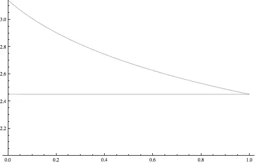

We have to solve the equation ${\rm sinc}(x)=a$ for $x\in[0,\pi]$ in terms of the parameter $a\in[0,1]$. As Kirill has remarked, for $a\to1\!-\ $ we obtain $x\doteq\sqrt{6(1-a)}$. Therefore, if we want a single simple expression giving accurate values over the whole $a$-interval $[0,1]$ we have to take a square root at the end.
For this reason we put $x:=\sqrt{u}$ and solve the equation $$\bigl(s(u):=\bigr)\quad {\rm sinc}\bigl(\sqrt{u}\bigr)=a\tag{1}$$ for $u$ in terms of $a$. Let $$a\mapsto u:=f(a)\qquad(0\leq a\leq1)$$ be the solution of $(1)$, i.e. the inverse function of $s$. From known values of $s$ and $s'$ we can, e.g., deduce the values $$f(0)=\pi^2,\quad f\left({2\over\pi}\right)={\pi^2\over4},\quad f\left({\sqrt{27}\over 4\pi}\right)={4\pi^2\over9},\quad f(1)=0\ ,\tag{2}$$ and $$f'(0)=-2\pi^2\tag{3}$$ (one could take more such values into account and determine more coefficients $c_k$, $d_k$ in the following).

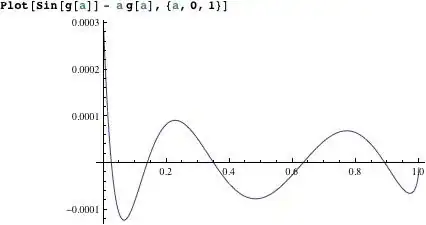

We now make the "Ansatz" $$\tilde f(a):={p(a)\over q(a)},\qquad p(a):=\pi^2+c_1 a+ c_2 a^2,\quad q(a):=1+d_1a +d_2 a^2\ ,$$ and determine the coefficients $c_1$, $c_2$, $d_1$, $d_2$ such that $(2)$ and $(3)$ are satisfied. This leads to the approximation $$x=g(a):=\sqrt{\tilde f(a)}=\sqrt{{\pi^2+5.95839 a - 15.828 a^2\over 1 + 2.60371 a + 0.690687 a^2}}\ .$$ The following figure shows a plot of $a\mapsto \sin\bigl(g(a)\bigr)-a\> g(a)$:

  • I worked based on your ideas and I made a quite good approximation. I added that to my question and let it for your review (if you wish). I would have liked to add a plot similar to your; the problem is that I am blind and producing graphics is very very hard to me. May be, if you wish, could you add one ? Thanks again. – Claude Leibovici Sep 29 '14 at 04:59
  • My wife just tells me that the plot is very nice and illustrative. Thanks again. Cheers :) – Claude Leibovici Sep 29 '14 at 10:22

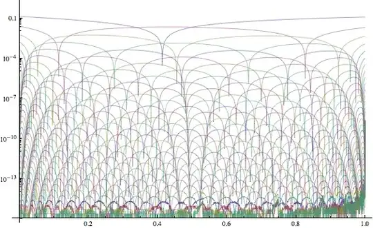

Instead of approximating $\sin x$ by some algebraic function, and then solving the approximate equation, let's approximate the true solution instead. Denote the solution $y(a)$, $0<y(a)<\pi$, $0<a<1$, of the equation $$ \sin y(a)-a y(a) = 0, $$ then $y(a)$ has a root, $y(1)=0$, and it behaves at $a\approx1$ as $$ y(a) \sim \sqrt{6}(1-a)^{1/2}. $$ Here is the graph of $y(a)/\sqrt{1-a}$:
Now the red function $y(a)/\sqrt{1-a}$ is smooth, non-singular, has no roots, so we can approximate it with a Chebyshev series $\sum_{k\geq0}c_k T_k(x)-\frac12 c_0$, with these coefficients:
[5.468893253088218, -0.3315308418632746, 0.05711908619285262, -0.0133386391330606, 0.003604590132654065, -0.001061080932244192, 0.0003303619584939474, -0.0001070040549514469, 3.56907424708586e-5, -1.217702854008323e-5, 4.22996639149332e-6, -1.491025149248465e-6, 5.319859653014493e-7, -1.917577069128536e-7, 6.972596591016018e-8, -2.554518680989035e-8, 9.420605435988877e-9, -3.494307402618534e-9, 1.302781037141137e-9, -4.879450499229215e-10, 1.835088955571608e-10, -6.927187870873964e-11, 2.62374324329517e-11, -9.968294055829801e-12, 3.797891128370018e-12, -1.450731732722623e-12, 5.554781896411238e-13, -2.131593799567149e-13, 8.196531167958859e-14, -3.15778010597506e-14, 1.218720260971691e-14, -4.711359031839824e-15, 1.824159314975387e-15, -7.073133344264407e-16, 2.746327946190114e-16, -1.067647609986269e-16, 4.153961510615797e-17, -1.613912600904692e-17, 6.171147771603768e-18, -2.090308692683401e-18]
Depending on how much accuracy you need, it might be enough to sum the first 34 terms using the Clenshaw recurrence (this takes 33 multiplications, and uses no expensive operations, like divisions). Here is the plot of relative error for successive Chebyshev approximations to $y(a)/\sqrt{1-a}$:
Depending on the relative cost of trigonometric operations on your machine (this should be established experimentally), it may be faster to take just enough Chebyshev terms that one Newton iteration suffices to get accuracy to machine precision. Here is 8 terms followed by one Newton iteration (blue) or one Halley iteration (red). The only expensive operation here would the simultaneous evaluation of sin and cos for the function and its derivative:
