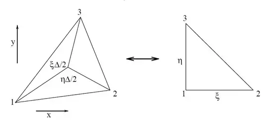

This is the reference that describes the transformation:
The main result is repeated here for convenience: $$ \left[ \begin{array}{c} x - x_1 \\ y - y_1 \end{array} \right] = \left[ \begin{array}{cc} (x_2 - x_1) & (x_3 - x_1) \\ (y_2 - y_1) & (y_3 - y_1) \end{array} \right] \left[ \begin{array}{c} \xi \\ \eta \end{array} \right] $$ Note that the triangle is half a parallelogram. And instead of transforming a parallelogram into a rectangle, an arbitrary triangle is transformed into a rectangular isosceles triangle. Therefore the above is in fact equivalent with any skew linear transformation (+ translation) : $$ \left[ \begin{array}{c} x \\ y \end{array} \right] = \left[ \begin{array}{cc} \alpha & \beta \\ \gamma & \delta \end{array} \right] \left[ \begin{array}{c} \xi \\ \eta \end{array} \right] + \left[ \begin{array}{c} p \\ q \end{array} \right] $$ If we define the coordinates of our transformed triangle as:
$\,(x_1,y_1) = (p,q)\,$ , $\,x_2 = \alpha + p\,$ , $\,x_3 = \beta + p\,$ , $\,y_2 = \gamma + q\,$ , $\,y_3 = \delta + q\,$.
Note.   Via Finite Element interpolations, other parent polytopes are associated with non-linear transformations. For example the standard quadrilateral with vertices
$(1)=(-1,-1)\, ,\, (2)=(+1,-1)\, ,\, (3)=(-1,+1)\, ,\, (4)=(+1,+1)\,$ has bilinear interpolation: $$ f = \frac{1}{4}(1-\xi)(1-\eta)f_1 + \frac{1}{4}(1+\xi)(1-\eta)f_2 + \frac{1}{4}(1-\xi)(1+\eta)f_3 + \frac{1}{4}(1+\xi)(1+\eta)f_4 \\ = \sum_{k=1}^4 N_k(\xi,\eta)\,f_k \qquad \mbox{with} \qquad N_k(\xi,\eta) = \frac{1}{4}(1\pm\xi)(1\pm\eta) $$ The accompanying (isoparametric) transformation is found by replacing $f$ with $x$ and $y$ : $$ x = \sum_{k=1}^4 N_k(\xi,\eta)\,x_k \qquad ; \qquad y = \sum_{k=1}^4 N_k(\xi,\eta)\,y_k $$ The bilinear transformation becomes linear again if the quadrilateral is a parallelogram , because then $\,x_1+x_4=x_2+x_3\,$ and $\,y_1+y_4=y_2+y_3\,$ (: diagonals property) , as substituted in: $$ f = (f_1+f_2+f_3+f_4)/4 + \xi\,(-f_1+f_2-f_3+f_4)/4 + \eta \, (-f_1-f_2+f_3+f_4)/4 \\ + \xi\eta\,(f_1-f_2-f_3+f_4) $$ and hence the last term becomes zero.
