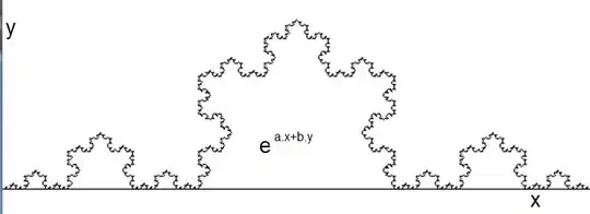

Grew out of frustration about this question; just replace "over" by "under":
What is $$ \iint_{K} e^{a \cdot x + b \cdot y} \,dx\,dy $$ integrated over the area between between the x-axis and the Koch curve. Assume that the Koch curve is between $(0,0)$ and $(1,0)$. It is common integration that is requested for, or at least an approximation to it. No fancy "measure" stories, just a method to calculate the integral, i.e. an algorithm or a series expansion (because it's reasonable to assume that there is no closed form).
A real number (approximation) for the case that $a=b=1$ would be nice, so that different outcomes can be compared.

But first we must calculate the exponent for an arbitrary triangle. The key mechanism for doing this is described in:
With this theory: $$ \iint_{K} e^{a \cdot x+ b \cdot y} \,dx\,dy =\\ \lim_{\#\Delta\to\infty} \sum_\Delta O_\Delta \int_0^1 \left[ \int_0^{1-\xi} e^{a \left[x_1 + (x_2-x_1)\xi + (x_3-x_1)\eta\right] + b \left[y_1 + (y_2-y_1)\xi + (y_3-y_1)\eta \right]}\;d\eta\right]d\xi $$ With $O_\Delta = (x_2-x_1)(y_3-y_1)-(x_3-y_1)(y_2-y_1)$ twice the area of the triangle $\Delta$.
The integrals can be computed exactly, for one triangle. You can do it by hand or invoke a computer algebra system. The result is: $$ \left[ {e^{a{\it x_2}+b{\it y_2}}}\,a{\it x_1}+{e^{a{\it x_2}+b{ \it y_2}}}\,b{\it y_1}-{e^{a{\it x_2}+b{\it y_2}}}\,a{\it x_3}-{ e^{a{\it x_2}+b{\it y_2}}}\,b{\it y_3}+{e^{a{\it x_3}+b{\it y_3}} }\,a{\it x_2}-{e^{a{\it x_3}+b{\it y_3}}}\,a{\it x_1}\\+{e^{a{\it x_3}+ b{\it y_3}}}\,b{\it y_2}-{e^{a{\it x_3}+b{\it y_3}}}\,b{\it y_1}-{e ^{a{\it x_1}+b{\it y_1}}}\,a{\it x_2}+{e^{a{\it x_1}+b{\it y_1}}}\,a{ \it x_3}-{e^{a{\it x_1}+b{\it y_1}}}\,b{\it y_2}+{e^{a{\it x_1}+b {\it y_1}}}\,b{\it y_3} \right]\\ / \left[ \left( -a{\it x_3}+a{\it x_1}-b{\it y_3}+ b{\it y_1} \right) \left( a{\it x_2}-a{\it x_3}+b{\it y_2}-b{ \it y_3} \right) \left( -a{\it x_2}+a{\it x_1}-b{\it y_2}+b{ \it y_1} \right) \right] $$ But after this first step I'm stuck, because it seems to become too prohibiting to proceed in this way. Any good ideas to make things more amenable and work towards completing the steps (2), (3) and (4)?
Han de Bruijn
  • 17,070
Instead of the proposed integration over the area under the Koch curve, it's easier to employ Green's theorem and integrate over the x-axis and then backwards over the Koch curve (i.e. in counterclockwise order): $$ \iint \left[ \frac{\partial Q}{\partial x} - \frac{\partial P}{\partial y} \right] \,dx\,dy = \oint \left[ P\,dx + Q\,dy \right] $$ There are several possible choices for $P(x,y)$ and $Q(x,y)$ but this one will be ours: $$ P(x,y) = -\frac{e^{a \cdot x + b \cdot y}}{b} \quad ; \quad Q(x,y) = 0 $$ Giving: $$ \iint_K e^{a \cdot x + b \cdot y} \,dx\,dy = - \frac{1}{b} \oint_K e^{a \cdot x + b \cdot y}\,dx = - \frac{1}{b}\int_0^1 e^{a \cdot x + 0}\,dx - \frac{1}{b} \int_K e^{a \cdot x + b \cdot y}\,dx $$ Where the last integral is over the Koch curve from the right $(1,0)$ to the left $(0,0)$. So: $$ \iint_K e^{a \cdot x + b \cdot y} \,dx\,dy = \left(1-e^a\right)/(ab) + \frac{1}{b}\int_K e^{a \cdot x + b \cdot y}\,dx $$ If we reverse the integration over the Koch curve from the left $(0,0)$ to the right $(1,0)$.
The method as proposed in the question is thus replaced by the following:
  1. Calculate the integral for an arbitrary line segment with vertex coordinates $(x_1,y_1),(x_2,y_2)$
  2. Find the vertices of all line segments in a finite iterand of the Koch curve
  3. Find the integral for this finite interand, which is the sum of known integrals over line segments
  4. Let the number of line segments grow to infinity; determine the limit eventually (and/or approximately)
First we must calculate the exponent for an arbitrary line segment $S$.
Let $\,x = x_1 + (x_2-x_1)t\,$ and $\,y = y_1 + (y_2-y_1)t$ , then: $$ \int_{S} e^{a \cdot x+ b \cdot y}\, dx = \int_0^1 e^{a \left[x_1 + (x_2-x_1)t \right] + b \left[y_1 + (y_2-y_1)t \right]}\;(x_2-x_1)\,dt =\\ (x_2-x_1)\frac{e^{a x_2 + b y_2}-e^{a x_1 + b y_1}}{(a x_2 + b y_2)-(a x_1 + b y_1)} $$ The following (Pascal) program defines finite iterands of a Koch curve, recursively. Arbitrary values of $a$ and $b$ can be substituted in the test procedure eventually. Several tests are built in to ensure that the program works correctly. The variable sum is used to sum up for the requested Zach integral, but another variable som is used to sum up for the Area under the Koch curve, which is exactly known for each iterand. The outcome of the integral for one triangle, as mentioned in the question, can be used for verifying the current integration procedure for the first interand Koch(1,a,b,1).

The outcome is expected to converge, but not very fast, and there is quite some loss of precision, as is seen with the Area outputs.
