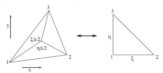

Triangle isoparametrics
The simplest Finite Element in two dimensions - and my absolute favorite - is the linear triangle:
Let's summarize the isoparametrics (= affine transformation) in the first place: $$ \begin{cases} x = x_1 + (x_2-x_1)\xi + (x_3-x_1)\eta \\ y = y_1 + (y_2-y_1)\xi + (y_3-y_1)\eta \\ f = f_1 + (f_2-f_1)\xi + (f_3-f_1)\eta \end{cases} $$ It will be shown next how partial differentiation at such a linear triangle takes place. First do the chain rules with global $(x,y)$ and local $(\xi,\eta)$ coordinates: $$ \begin{cases} \Large \frac{\partial f}{\partial \xi} = \frac{\partial f}{\partial x}\frac{\partial x}{\partial \xi} + \frac{\partial f}{\partial y}\frac{\partial y}{\partial \xi} \\ \Large \frac{\partial f}{\partial \eta} = \frac{\partial f}{\partial x}\frac{\partial x}{\partial \eta} + \frac{\partial f}{\partial y}\frac{\partial y}{\partial \eta} \end{cases} \quad \Longleftrightarrow \quad \Large \begin{bmatrix} \frac{\partial f}{\partial \xi} \\ \frac{\partial f}{\partial \eta} \end{bmatrix} = \begin{bmatrix} \frac{\partial x}{\partial \xi} & \frac{\partial y}{\partial \xi} \\ \frac{\partial x}{\partial \eta} & \frac{\partial y}{\partial \eta} \end{bmatrix} \begin{bmatrix} \frac{\partial f}{\partial x} \\ \frac{\partial f}{\partial y} \end{bmatrix} $$ But what we need is the inverse, with determinant / Jacobian $\;\Delta = (\partial x / \partial \xi)(\partial y / \partial \eta) - (\partial x / \partial \eta)(\partial y / \partial \xi)$ : $$ \Large \begin{bmatrix} \frac{\partial f}{\partial x} \\ \frac{\partial f}{\partial y} \end{bmatrix} = \begin{bmatrix} \frac{\partial x}{\partial \xi} & \frac{\partial y}{\partial \xi} \\ \frac{\partial x}{\partial \eta} & \frac{\partial y}{\partial \eta} \end{bmatrix}^{-1} \begin{bmatrix} \frac{\partial f}{\partial \xi} \\ \frac{\partial f}{\partial \eta} \end{bmatrix} = \begin{bmatrix} \frac{\partial y}{\partial \eta} & -\frac{\partial y}{\partial \xi} \\ -\frac{\partial x}{\partial \eta} & \frac{\partial x}{\partial \xi} \end{bmatrix} / \Delta \begin{bmatrix} \frac{\partial f}{\partial \xi} \\ \frac{\partial f}{\partial \eta} \end{bmatrix} $$ Giving full discretization of the function derivatives, with determinant / Jacobian $\;\Delta = (x_2-x_1)(y_3-y_1)-(x_3-x_1)(y_2-y_1)$ : $$ \Delta \begin{bmatrix} \partial f / \partial x \\ \partial f / \partial y \end{bmatrix} = \begin{bmatrix} (y_3-y_1) & -(y_2-y_1) \\ -(x_3-x_1) & (x_2-x_1) \end{bmatrix} \begin{bmatrix} f_2-f_1 \\ f_3-f_1 \end{bmatrix} $$ Here $\Delta$ is the area of a vector parallelogram, which is twice the area of the triangle. The above can also be written as: $$ \Delta \left[ \begin{array}{c} \partial f / \partial x \\ \partial f / \partial y \end{array} \right] = \left[ \begin{array}{ccc} +(y_2 - y_3) & +(y_3 - y_1) & +(y_1 - y_2) \\ -(x_2 - x_3) & -(x_3 - x_1) & -(x_1 - x_2) \end{array} \right] \left[ \begin{array}{c} f_1 \\ f_2 \\ f_3 \end{array} \right] $$ The matrix in this last formula should be memorized; it is called a differentiation matrix.

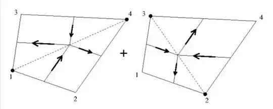

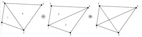

In addition, what we want is a configuration in which all quad vertices play an equally important role. In order to accomplish this, all of the four triangles must be present in our formulation, simultaneously. For just one quadrilateral, it boils down to renumbering vertices in the formulation for a single triangle, according to the following permutations:
   1  2  3       2  4  1       3  1  4       4  3  2
Also an upper label (not a power) will be attached to the values $(Q_x,Q_y)$, because it must be denoted at which triangle the discretization takes place. Any contributions are summed now over the four triangles (and the whole is divided by a factor two again): $$ \frac{1}{4} \left[ \begin{array}{ccc} f_1 & f_2 & f_3 \end{array} \right] \left[ \begin{array}{c} (y_3 - y_2) Q^1_x - (x_3 - x_2) Q^1_y \\ (y_1 - y_3) Q^1_x - (x_1 - x_3) Q^1_y \\ (y_2 - y_1) Q^1_x - (x_2 - x_1) Q^1_y \end{array} \right] + $$ $$ \frac{1}{4} \left[ \begin{array}{ccc} f_2 & f_4 & f_1 \end{array} \right] \left[ \begin{array}{c} (y_1 - y_4) Q^2_x - (x_1 - x_4) Q^2_y \\ (y_2 - y_1) Q^2_x - (x_2 - x_1) Q^2_y \\ (y_4 - y_2) Q^2_x - (x_4 - x_2) Q^2_y \end{array} \right] + $$ $$ \frac{1}{4} \left[ \begin{array}{ccc} f_3 & f_1 & f_4 \end{array} \right] \left[ \begin{array}{c} (y_4 - y_1) Q^3_x - (x_4 - x_1) Q^3_y \\ (y_3 - y_4) Q^3_x - (x_3 - x_4) Q^3_y \\ (y_1 - y_3) Q^3_x - (x_1 - x_3) Q^3_y \end{array} \right] + $$ $$ \frac{1}{4} \left[ \begin{array}{ccc} f_4 & f_3 & f_2 \end{array} \right] \left[ \begin{array}{c} (y_2 - y_3) Q^4_x - (x_2 - x_3) Q^4_y \\ (y_4 - y_2) Q^4_x - (x_4 - x_2) Q^4_y \\ (y_3 - y_4) Q^4_x - (x_3 - x_4) Q^4_y \end{array} \right] \mbox{ } $$ The four overlapping triangles at the corners of the quadrilateral are a small but significant twist to the standard Finite Element Method, which is motivated by the end-result.

Apply a Finite Element (Galerkin) method to a mesh of quadrilaterals. Subdivide each of the quads into four (overlapping) triangles, in the two ways that are possible. Then such a method is equivalent to a Finite Volume method: midsides of the triangles, around the vertex of interest, are neatly connected together, to form the boundary of a 2-D finite volume, and the conservation law is integrated over this volume.
Unification of a Finite Element and a Finite Volume method has been accomplished herewith, for a restricted class of 2-D diffusion problems.

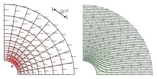

Labrujère's Problem
In Februari 1976, Dr. Th.E. Labrujère, at the National Aerospace Laboratory NLR, the Netherlands, wrote a memorandum which is titled, when translated in English: The "Least Squares - Finite Element" Method [L.S.FEM] applied to the 2-D Incompressible Flow around a Circular Cylinder. To be more precise: incompressible and irrotational flow.
In this memorandum, it was firmly established that a straightforward application of the Least Squares Method, using linear triangular Finite Elements, quite unexpectedly, does not work well. Herewith, Labrujère's report is demonstrating a scientific integrity which is rarely seen these days. With our own software we have been able to reproduce the poor results as obtained by NLR:
Improving on these results has been a non-trivial task. On the side of NLR, it could only be accomplished by introducing highly complicated elements. On the side of myself, it could only be accomplished by adopting an approach which is quite deviant from the common Finite Element methodology. It has to be decided by Occam's Razor which of the two approaches is to be preferred.
The Calgary Solution
In December 1976, Labrujère's problem was "solved" by G. de Vries, T.E. Labrujère himself and D.H. Norrie, at the mechanical Engineering Department of The University of Calgary, Alberta, Canada. The result is written down in their Report no.86: A Least Squares Finite Element Solution for Potential Flow. The abstract of this report is copied here:
It seems to me that the above solution is of pure academical interest, though. The apparent need for fifth-order trial functions shall make this method unworkable in practice. Even if attention is restricted to the simple case at hand, it's way too complicated. What's worse, generalization is likely to be hard. In the end, 2-D and 3-D Navier Stokes equations (at a curvilinear grid, preferably) need to be solved. So the point of departure must be something which is much more simple. Especially the number of unknowns at each nodal point should not exeed the absolute minimum, the number of degrees of freedom: two. I have never been in doubt that an alternative least squares finite element solution, having such desirable properties, must be possible. I have a dream ..

We are ready now to look at Labrujère's problem in the following way. Let it be required that the Least Squares Finite Element Method always leads to an acceptable solution, with moderate mesh sizes. Then, of course, in the associated Finite Difference system, the number of unknowns $N$ should be equal to the number of independent equations $M$. If such is not the case, namely, then the system is likely to be overdetermined. And it is doubtful if the Least Squares minimum can still approach zero, fast enough. A simple count of the triangles involved with Labrujère's problem reveals that such kind of a delicate balance between unknowns and equations is definitely not achieved there: the number of elements outweights the number of nodal points by a factor $2$! This means that there are roughly twice as many "unsquared" F.D. equations as there are unknowns. Apart from of any more complicated kind of argument, like higher order continuity, this surely throws up a basic question.
I am not qualified to check out whether Norrie and DeVries implicitly adressed that question, in their report. They first kept the triangular shapes. I guess that, in order to compensate for an abundance of elementary equations, they had to introduce even so many additional variables. Now it becomes clear what kind of different approach may be feasible here. For the only thing that has to be accomplished is: a perfect balancing between the number of equations and the number of unknowns. Instead of increasing both these numbers by some complicated mechanism.
