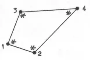

It is argued in this answer @ MSE that integration (points) at the vertices of a finite element are often the best. Accompanying pictures are inserted here too for convenience:
An interesting consequence is splitting of the quadrilateral in four linear triangles:
This makes the discretization of the terms $\,+fu=g\,$ extremely simple: $$ + \frac{1}{4} \begin{bmatrix} f_1\cdot\Delta_1 & 0 & 0 & 0 \\ 0 & f_2\cdot\Delta_2 & 0 & 0 \\ 0 & 0 & f_3\cdot\Delta_3 & 0 \\ 0 & 0 & 0 & f_4\cdot\Delta_4 \end{bmatrix} \begin{bmatrix} u_1 \\ u_2 \\ u_3 \\ u_4 \end{bmatrix} = \frac{1}{4} \begin{bmatrix} g_1\cdot\Delta_1 \\ g_2\cdot\Delta_2 \\ g_3\cdot\Delta_3 \\ g_4\cdot\Delta_4 \end{bmatrix} $$ Here $\Delta_k$ is twice the area of the triangle numbered as $(k)$.
