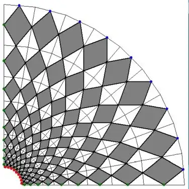

Around a circular cylinder
The $9\times 9$ computational grid with Varignon parallelograms is shown.
Boundary conditions are as follows: $$ \begin{cases} \color{red}{\mbox{inner circle impermeable:}} & (\vec{w}\cdot\vec{AB}) = 0 \\ \color{blue}{\mbox{outer circle uniform flow:}} & u = 1 \\ \color{green}{\mbox{inflow opening left:}} & v = 0 \\ \color{green}{\mbox{line of symmetry bottom:}} & v = 0 \end{cases} $$ The curvilinear grid is topologically equivalent with a $\mbox{NDX}\times\mbox{NDY}$ rectangular grid (with $\mbox{NDX}=\mbox{NDY}=9$).
Let's make a count of the unknowns and the equations and see if there is a match. First the unknowns: $$ \mbox{# velocities } (u,v) = 2\times\left[\mbox{NDX}(\mbox{NDY}+1)+\mbox{NDY}(\mbox{NDX}+1)\right] \quad \Longrightarrow \\ \mbox{# unknowns} = 4\times\mbox{NDX}\times\mbox{NDY}+2\times\mbox{NDX}+2\times\mbox{NDY} $$ Second the equations: $$\begin{cases} \mbox{# incompressible + irrotational} = 2\times \mbox{NDX}\times\mbox{NDY} \\ \mbox{# boundary conditions} = 2\times \left[\mbox{NDX}+\mbox{NDY}\right]\end{cases} \quad \Longrightarrow \\ \mbox{# equations} = 2\times\mbox{NDX}\times\mbox{NDY}+2\times\mbox{NDX}+2\times\mbox{NDY} $$ Therefore $2\times\mbox{NDX}\times\mbox{NDY}$ equations are missing. Did we forget something? Yes we did!
Remember the coordinates of the Varignon parallelogram: $$ (x_1,y_1) = \frac{\vec{A}+\vec{C}}{2} \quad ; \quad (x_2,y_2) = \frac{\vec{B}+\vec{D}}{2} \quad ; \quad (x_3,y_3) = \frac{\vec{A}+\vec{B}}{2} \quad ; \quad (x_4,y_4) = \frac{\vec{C}+\vec{D}}{2} $$ However, the above does not hold only for the coordinates; it holds for any function $T$ at the parallelogram. This phenomenon is known in Finite Element circles as isoparametrics: $$ T_1 = \frac{T_A+T_C}{2} \quad ; \quad T_2 = \frac{T_B+T_D}{2} \quad ; \quad T_3 = \frac{T_A+T_B}{2} \quad ; \quad T_4 = \frac{T_C+T_D}{2} $$ Herefrom we easily conclude, quite in general: $$ \frac{T_A+T_B+T_C+T_D}{2} = T_1 + T_2 = T_3 + T_4 $$ for any function $T$, in particular for the coordinates, but also for the velocity components $(u,v)$ : $$ u_1 + u_2 = u_3 + u_4 \quad ; \quad v_1 + v_2 = v_3 + v_4 $$ So here we are! The isoparametrics is giving us exactly the $2\times\mbox{NDX}\times\mbox{NDY}$ equations that we were missing. We end up with $N$ independent linear equations with $N$ unknowns (: $N = 360$).
A system that can be solved, in principle. There is one little problem, however. With many Finite Difference discretizations, the resulting linear system is such that one can tell which equation belongs to which unknown. But our system is such that it is impossible to order them according to the unknowns. It is for this reason that a somewhat indirect solution method may be preferred: Least Squares. I'm not going to explain this method again and again. Relevant MSE references:
