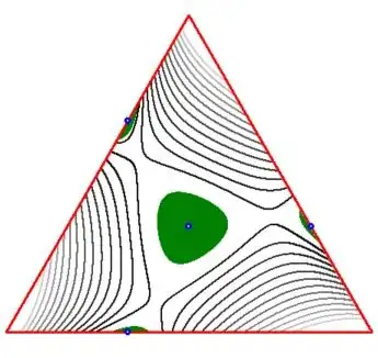

Proof without words (more like a pictural comment). The following reference gives some clues about the know how to do such a thing:

Define the function to be investigated as: $$ F(a,b,c) = \sqrt{24a^2b+25}+\sqrt{24b^2c+25}+\sqrt{24c^2a+25} - 21 $$ Scanning the inside of the triangle (picture on the left) pixel by pixel (i.e. numerically) reveals that:
minimum = -5.97874499595267E+0000 ; maximum = -1.86093567294196E-0005
The exact minimum is at the vertices of the triangle: $F(3,0,0)=F(0,3,0)=F(0,0,3)=-6$ , just beyond reach of the numerics.
Contour lines of the function are shown in the picture on the right. They are at:
for g := 1 to 16 do
begin
  level := -sqr(g/8); { level = minus g/8 squared }
More black means closer to the maximum. Of course we already know that: $$ F(1,1,1) = 0 \; ; \; F(2,1,0) = 0 \; ; \; F(0,2,1) = 0 \; ; \; F(1,0,2) = 0 $$ These places are indicated as $\color{blue}{blue}$ spots in the picture on the right. So there is strong evidence (ipse est NO "rigorous proof") that $0$ is indeed the maximum. My 2 cents worth ..
EDITs. Picture on the right augmented with $\color{green}{green}$ areas where $|F(a,b,c)| < 0.1$ .
