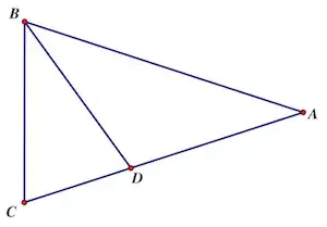

diagram
Consider a $\triangle ABC$ with $AB=1$, $\mathrm{m}\angle A=\frac{\pi}{5}$ and $\mathrm{m}\angle B=\mathrm{m}\angle C=\frac{2\pi}{5}$, and point $D$ on $\overline{AC}$ such that $\overline{BD}$ bisects $\angle ABC$. Now, $\mathrm{m}\angle CBD=\frac{\pi}{5}$ and $\mathrm{m}\angle BDC=\frac{2\pi}{5}$, so $\triangle ABC\sim\triangle BCD$. Also note that $\triangle ABD$ is isosceles so that $BC=BD=AD$.
Let $x=BC=BD=AD$. From the similar triangles, $\frac{AB}{BC}=\frac{BC}{CD}$ or $\frac{1}{x}=\frac{x}{1-x}$, so $1-x=x^2$ and $x=\frac{\sqrt{5}-1}{2}$ (the other solution is negative and lengths cannot be negative).
Now, apply the Law of Cosines to $\triangle ABC$: $$\begin{align} \cos\frac{2\pi}{5}=\cos C&=\frac{a^2+b^2-c^2}{2ab} \\\\ &=\frac{\left(\frac{\sqrt{5}-1}{2}\right)^2+1^2-1^2}{2\cdot\frac{\sqrt{5}-1}{2}\cdot 1} \\\\ &=\frac{\frac{\sqrt{5}-1}{2} \cdot \frac{\sqrt{5}-1}{2}}{2\cdot\frac{\sqrt{5}-1}{2}} \\\\ &=\frac{\sqrt{5}-1}{4}. \end{align}$$
Isaac
  • 36,557
    @MFV: Given the context of your question, it seemed that you'd want a proof that was more geometrically oriented. In my head, the triangle I used is the triangle-equivalent of the golden rectangle. Also, if you draw a regular pentagon and all its diagonals, you'll see the diagram I drew as a small part of the picture (AB is a side, C and D are inside the pentagon at intersections of diagonals). – Isaac Oct 24 '10 at 21:51
