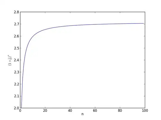

I think it's instructive to look at what happens as n grows. At the bottom of my answer I've attached a plot showing $(1 + \frac{1}{n})^n$ as a function of n from 1 to 100.
Hopefully this plot makes a little intuitive sense. Although as $n\to\infty$, $(1 + \frac{1}{n})$ gets very small, you are raising it to a higher and higher power.
For example, when $n = 10$:
$$1 + \frac{1}{10} = 1.1$$
which is pretty close to $1$, but!
$$1.1^{10} \approx 2.6$$

  • you probably meant to say that $1+\frac{1}{n}$ gets very close to $1$, rather than say that it gets very small. 2) The example you give later is a bit problematic for the purposes of the question. The substitution you give fails because of the term $0/0$. But then you show the correct computation, where you can eventually substitute and get the right answer. The issue is that substitution to compute limits is a good technique, but while it may work (under the suitable conditions), it never applies to substituting $\infty$. $\infty $ is not a number.
  • – Ittay Weiss Nov 03 '13 at 21:42
  • @IttayWeiss, 1) Yes you are right; I just noticed that. 2) You raise a good point. I initially thought the major mistake was the substitution, but in fact it is a combination of the substitution and $\infty$. I guess the second example, although it doesn't clearly illuminate the poster's mistake, still goes to show that simple substitution does not always work. I think the method of plotting the result for increasing n is a very good way to visualize what is happening during the limiting process. – user545424 Nov 03 '13 at 21:53
