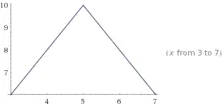

$y=m(x-a)sgn(a-x)+ma$
Plot $m=2, a=5$:
So is there any way to build an equation for triangle without using the $x$ axis as the 3rd side of the triangle?

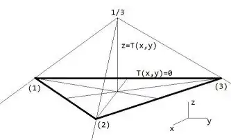

The formulas which express the local coordinates $\xi$ and $\eta$ into the global coordinates $x$ and $y$ are repeated here for convenience: $$ \begin{array}{ll} \xi = [ (y_3 - y_1).(x - x_1) - (x_3 - x_1).(y - y_1) ]/\Delta \\ \eta = [ (x_2 - x_1).(y - y_1) - (y_2 - y_1).(x - x_1) ]/\Delta \end{array} $$ Here $\Delta$ is the determinant of the inverse transformation.
With the above, the "closed" triangle equation $T(x,y) = 0$ is simply given with: $$ T(x,y) = \min( \xi , \eta , 1 - \xi - \eta )$$ enter image description here
The maximum of the function $T$ is reached for $\xi = \eta = 1 - \xi - \eta = 1/3$ , hence at the midpoint (barycenter) of the triangle. If we draw straight lines from the midpoint towards the vertices, and further, then the whole plane is subdivided into three regions, one where $T(x,y) = \xi$ , one where $T(x,y) = \eta$ and one where $ T(x,y) = 1 - \xi - \eta$ . Our "inside/outside" function $T$ is zero at the triangle sides, positive inside and negative outside. It's shaped like a mountain with top $1/3$ at the midpoint and three sharply edged slopes downhill. The contour lines of this function are triangles, where the contour line with height $0$ is the original triangle itself. ( Quite the same is the case with the equation of e.g. a circle: $C(x,y) = 0$ with $C(x,y) = R^2 - (x-a)^2 - (y-b)^2$. )
