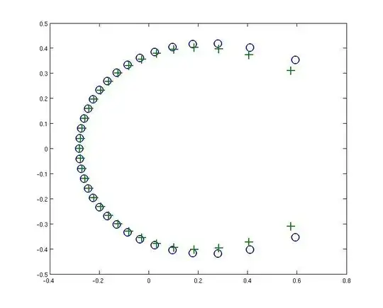

Here is a plot curve for the case $n=33$ (it only works for uneven $n$). Using the lambert W function comes from formula (1.1) from paper 221 available from here. This formula is:

Here is an octave script for such a plot as the one above (To use lambertw(), as in the script, install the 'specfun' package for octave - or use a more number/function theory centric system than octave).

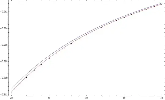

Below is a plot of the numerical solutions to $s_{2n+1}((2n+1)z) = 0$ near $z=-W(1/e)$ as black dots, Szegő's approximation $(2)$ as a blue line, and the approximation in $(3)$ as a red line for $20 \leq n \leq 40$.
