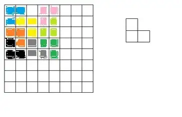

Another example and some proof.
On some special case of putting monomino in special place, $(2m-1)×(2m-1)$ without multiple of 3 are possible. If a monomino is black, since $(6m-1)^2=3*4m(3m-1)+1$, L blocks is a multiple of 4. Then it's contradiction, so white - black=2. Therefore when $(6m-1)^2$, we can't put a monomino in a place we like. If $(6m)^2$, although L blocks is obviously odd, since $(6m^2-3)+1≠6m^2$, they can't make square. If $(6m-3)^2$, since $(6m-3)^2≠3M+1$, they can't make square.
enter image description hereenter image description here
