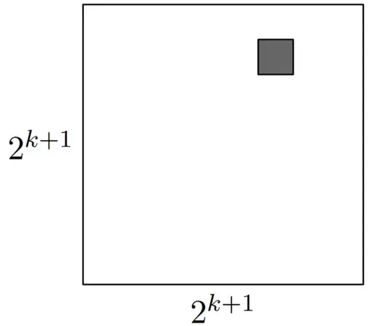

Lets consider a $2^{k+1}\times 2^{k+1}$ grid, with one square deleted.
pic1
We will use the induction hypothesis. So, we can isolate the the $2^k\times 2^k$ quadrant that contains the removed square. We then can remove the middle $L$-tromino, divide the remaining grid into three $2^k × 2^k$ grids, each with a deleted square, such that the three deleted squares are adjacent to each other. As shown below;
pic2
We then have four $2^k\times 2^k$ grids with a deleted square, and by the induction hypothesis, each can be tiled with $L$-trominoes. Therefore, the whole $2^{k+1}\times 2^{k+1}$ chessboard with a deleted square can be tiled with $L$-trominoes. The result is true for $n=k+1$, and by induction, it is true for all positive integers $n$.
