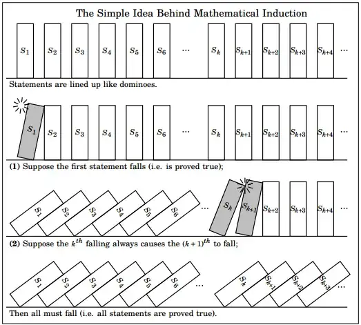

I'd use a visual method to explain the concept before "complicating" it with numbers. Falling dominoes seem intuitive and capture the essence of induction.
To visualize it, think of the statements as dominoes, lined up in a row. Imagine you can prove the first statement S1, and symbolize this as domino S1 being knocked down. Additionally, imagine that you can prove that any statement Sk being true (falling) forces the next statement Sk+1 to be true (to fall). Then S1 falls, and knocks down S2. Next S2 falls and knocks down S3, then S3 knocks down S4, and so on. The inescapable conclusion is that all the statements are knocked down (proved true).
The Simple Idea Behind Mathematical Induction
(Source: p143 of Book of Proof by Richard Hammack)
(You could also go off on a tangent about abstraction in mathematics analogies.)

  • I love this; it makes an old thing look elegent and more beautiful than it was before. – 000 May 18 '12 at 01:16
  • @jabolotai : What do you do about the commonplace empirical observation that this does not work: students who see just this explanation fail to understand it? I was puzzled by this at one time. I suspect now that it had never before occurred to those students that in mathematics one should learn to understand why something must be true rather than simply learning to execute algorithms that come from textbooks and instructors. Then they come to this topic and it's the only time they've thought about how to prove something, and they don't know what "prove something" means. ${}\qquad{}$ – Michael Hardy Jan 25 '15 at 18:48
  • @MichaelHardy Give the kids real dominoes. If that fails give them a real text book. If I have to explain the rest step by step, you might not understand it :) Seriously, perhaps teach "proof" by another means first then do induction. Knowing when to use an algorithm is still a good start towards truly grokking something. – aportr Jan 26 '15 at 00:57
  • @jabolotai : To think that giving them real dominoes would help is silly. Everyone among them already has a perfect understanding of how real dominoes work. To teach "proof" from scratch would help, but the big obstacle is that students treat learning the subject as a price paid to get a grade rather than as the thing they showed up for, and that makes everything hopeless. – Michael Hardy Jan 26 '15 at 05:07
  • @MichaelHardy It's not hopeless; Some students passion lies elsewhere so even with a perfect inductive teaching method they still wouldn't intrinsically get or appreciate it. Occasionally though you might inspire someone.
    Real dominoes and the algorithmic explanation was my attempt at a joke. Ha. Although, a good physical analogy can be a powerful visualising tool - e.g. domino computer https://www.youtube.com/watch?v=OpLU__bhu2w
    People learn in a variety of styles, so perhaps mix up the delivery method a bit if they still don't get it.
    – aportr Jan 27 '15 at 14:34
