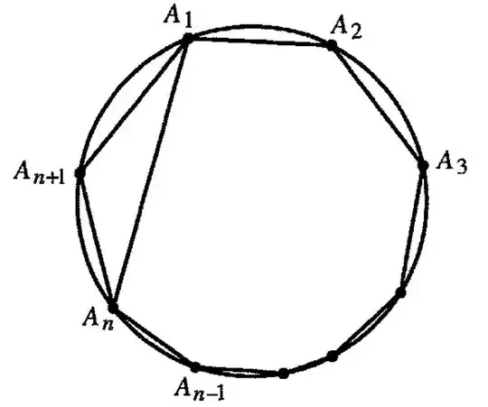

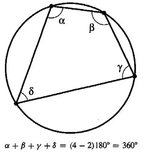

$\textbf{Problem 1:}$ For all $n\in \mathbb{N}$, if $n\ge 3$, then if $n$ distinct points on a circle are connected in consecutive order with straight lines, then the interior angles of the resulting polygon add up to $(n-2)180º$.
Case $n=4$:
Inductive step:

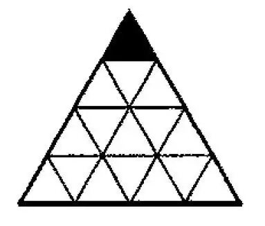

$\textbf{Problem 2:}$ Let $n\in \mathbb{N}$. An equilateral triangle is cut into $4^n$ congruent equilateral triangles, and one corner is removed. Show that the remaining area can be covered by trapezoidal tiles that look like this: .
Case $n=2$:

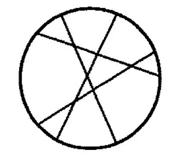

$\textbf{Problem 3:}$ Let $n\in \mathbb{N}$. Suppose $n$ chords are drawn in a circle in such a way that each chord intersects every other, but no three intersect at one point. Prove that the chords cut the circle into $\displaystyle \frac{n^2+n+2}{2}$ regions.
Case $n=4$:

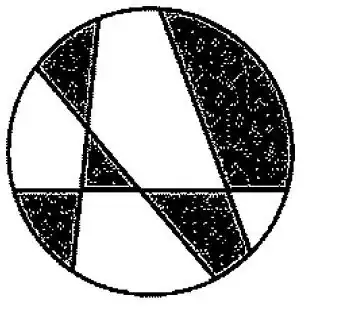

$\textbf{Problem 4:}$ Let $n\in \mathbb{N}$ and suppose that $n$ chords are drawn in a circle, cutting the circle into a number of regions. Prove that the regions can be colored with two colors in such a way that adjacent regions (that is, regions that share an edge) are different colors.
Case $n=4$:

1The interior angles of any polygon add up to $\pi(n-2)$, the fact that it's inscribed in a circle is irrelevant. The proof suggested in the second picture works even if you forget about the circle. – Kevin Casto Oct 23 '15 at 03:18
