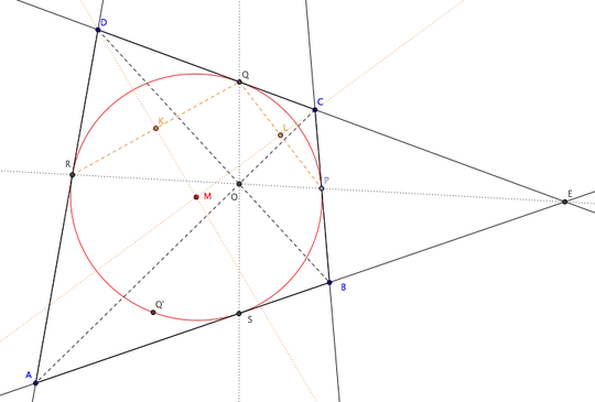

As explained in this answer, once you choose one of the tangency points the other three can be uniquely constructed from the properties of the perspective transformation carrying the quadrilateral to a square.
If you want, in particular, the ellipse corresponding to the circle inscribed into the square, then the construction is very simple (see figure below): join the intersection point $O$ of the diagonals with the concurrence points $E$, $F$ of the opposite sides: lines $EO$ and $FO$ intersect the sides of quadrilateral $ABCD$ at tangency points $PQRS$.
One can then find the centre $M$ of the ellipse as the intersection of lines $DK$, $CL$, where $K$, $L$ are the midpoints of $QR$, $PQ$. If you need to find the equation of the ellipse, you can construct a fifth point $Q'$ as the reflection of $Q$ about $M$. Otherwise, you can use geometric techniques to find axes and foci.

  • That is a very straightforward method. Can you explain why joining O with E and F gives the tangent points? – Msegade Feb 16 '22 at 15:02
    @Msegade It's all explained in the linked answer: a circle inscribed into a square is tangent at the midpoints of the sides. A line through one of these midpoints, parallel to the other sides, intersects the diagonals of the square at their intersection point $O$. But parallel lines become concurring after a perspective transformation, whence the above construction. – Intelligenti pauca Feb 16 '22 at 15:16
    @Msegade In other words: in the square line $POR$ is parallel to $CD$ and $AB$, hence in the transformed quadrilateral the same lines are concurrent. Ditto for line $QOS$ with $BC$ and $AD$. – Intelligenti pauca Feb 16 '22 at 15:49
  • Thanks, it is clear now. – Msegade Feb 16 '22 at 15:50
