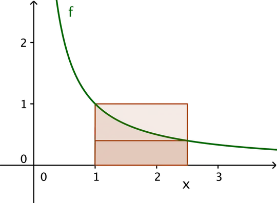

If you don't already know that $\log(x)=\int_1^x\frac1t\,dt$, one way to define the logarithm function is: $$\text{$\log(x)$ is the area under the curve $y=\frac1t$ from $t=1$ to $t=x$.}$$ The picture below shows that this area is sandwiched between two rectangles, each of width $x-1$. The smaller rectangle has height $1/x$, while the larger one has height $1$. In other words, we have the following inequalities:
$$(x-1)\cdot \frac1x\le\log(x)\le(x-1)\cdot 1$$
