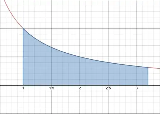

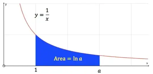

I might be stating the obvious here, but:
$$\ln(a) = \int_1^a \frac{dx}{x}$$
means that $\ln(a)$ is defined as the area under the curve $\frac{1}{x}$ between $1$ and $a$.
Note : if $a < 1$, $\ln(a)$ is the opposite of the area under the curve $\frac{1}{x}$ between $a$ and $1$.
From this diagram, we notice that :
  • $\ln(1)$ is $0$ because the blue area will be an empty rectangle.
  • $\ln(x)$ is stricly increasing.
  • $\ln(x) > 0$ when $x > 1$
  • $\ln(x) < 0$ when $x < 1$
  • Somewhere between 2 and 3, the blue area will be as large as one grid square. $\ln(x) = 1$ will have a unique solution, with $2 < x < 3$.
  • $1/x$ becomes infinitely high close to $0$, and infinitely small towards $\infty$. It means $\ln(x)$ is increasing very fast between $0$ and $1$ and very slowly between $1$ and $\infty$.

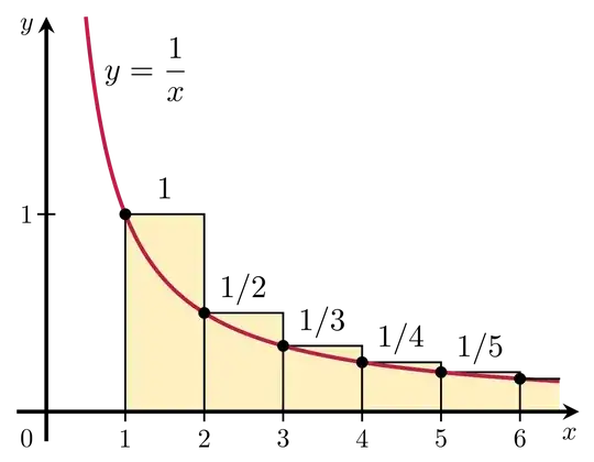

One possible way to approximate the area is to sum rectangles:
The rectangles are always too large and cover the blue area completely, but the approximation could be made better by taking thinner rectangles.
