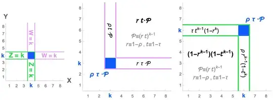

Denote $W \equiv \min(X,Y)$ as the smaller among the two and $Z \equiv \max(X,Y)$ as the larger. The key observation to solve this problem is that $$Z \overset{d}{=} R~, \qquad\qquad \textbf{the maximum has the same distribution as the 'rounds'.}$$ This allows one to think about the whole scenario differently (not as rounds of a two-player game). For all $k \in \mathbb{N}$, since $X \perp Y$ we have \begin{align*} \Pr\{ Z = k \} &= \Pr\{ X < Y = Z = k \} \\ &\hspace{36pt} + \Pr\{ Y < X = Z = k \} \\ &\hspace{72pt} + \Pr\{ X = Y = Z = k \} \\ &= \tau (1 - \tau)^{k-1} (1 - (1-\rho)^k) \\ &\hspace{36pt} + \rho (1 - \rho)^{k-1} (1 - (1-\tau)^k) \\ &\hspace{72pt} + \rho\tau (1 - \rho)^{k-1} (1 - \tau)^{k-1} \tag*{Eq.(9)} \label{Eq09} \end{align*} In principle, now that the distribution of $Z$ (thus $R$) is completely specified, everything one would like to know can be calculated. This is indeed a valid approach (to obtain the mean and variance), and the terms involved are all basic series with good symmetry.
Note that $Z$ is not Geometric (while $X$, $Y$, and $W$ are), nor is it Negative Binomial. At this point, it is not really of interest that \ref{Eq09} can be rearranged into a more compact and illuminating form ...... because we can do even better.
There are two more observations that allow one to not only to better calculate but also understand the whole picture. \begin{align*} &X+Y = W + Z \tag*{Eq.(10)} \label{Eq10} \\ &W \sim \mathrm{Geo[\lambda]} \tag*{Eq.(11)} \label{Eq11} \end{align*} This is the special case of the sum of the order statistics being equal to the original sum. In general with many summands this not very useful, but here with just two terms it is crucial.
Back to the two-player game scenario, the fact that $W$ is Geometric with success probability $\lambda = 1 - (1 - \rho)(1 - \tau)$ is easy to see: a round 'fails' if and only if both flips 'fail', with a probability $(1 - \rho)(1 - \tau) = 1 - \lambda$.
The contour of $W = k$ is L-shaped boundary of the '2-dim tail', which fits perfectly with the scaling nature (memoryless) of the joint of two independent Geometric distribution. Pleas picture in the figure below that $\Pr\left\{W = k_0 + k ~ \middle|~~ W > k_0 \right\} = \Pr\{ W = k\}$ manifests itself as the L-shape scaling away.
The contour of $Z = k$ looks like $\daleth$, and together with the L-contour of $W$ they make a cross. This is \ref{Eq10} the identity $X+Y = W+Z$, visualized in the figures below. See Appendix.B.1 for the linked in-site posts of related topics.
