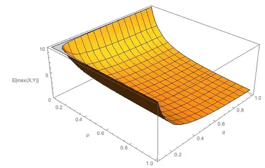

Let $X \sim Geometric(p)$ and $Y \sim Geometric(q)$ where $X$ and $Y$ are strictly positive independent random variables. Then $(X,Y)$ have joint pmf $f(x,y)$:
Part 1: You seek:
where I am using the Expect function from the mathStatica package for Mathematica to do the nitty-gritties.
Here is a plot of the solution $E[max(X,Y)]$, as parameters $p$ and $q$ vary:
